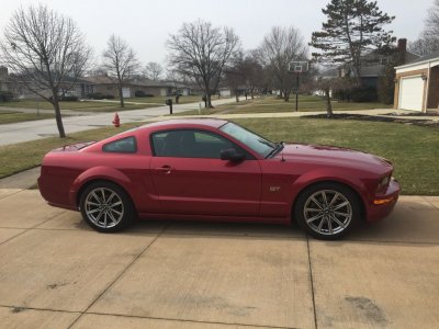

I have new 20” wheels but there’s still wheel well gap. So I want to lower my car.
Tire size, not wheel size, along with springs will determine the wheel fender gap. 29" tires on 18" rim fills it up well all the way around. I have springs too but a bigger tire fills the gap all the way around, not just at the top.
