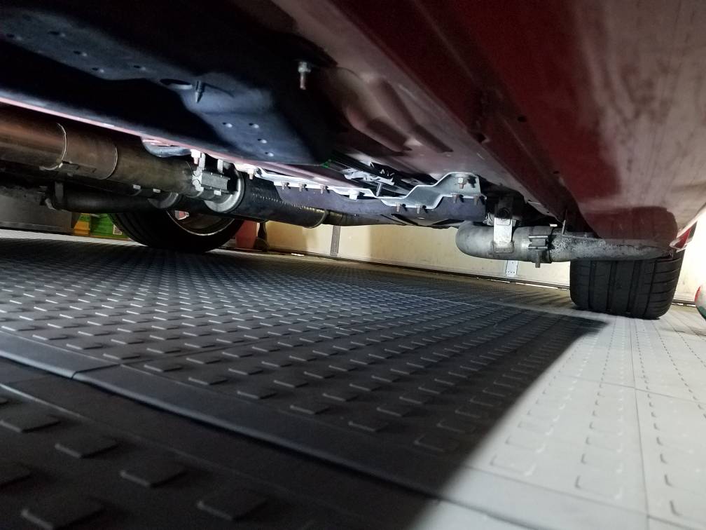

I don't think there's any way you could fit an oval case muffler under there with the factory fuel tank in place. As 07gts197 said, even regular round case mufflers just barely fit.

Well that's what I am thinking. With them being small and borla saying they were using them mid-mounted. Side exhaust has been a bitch for good sounding setups. @ghunt81 what are you running there? I looked at some race bullets but 200.00 to find out how drone, no thanks.
Those are magnaflow 10416's if I recall correctly. Found them on a website super cheap about 4-5 years ago (like $38 each). Pretty much those are the ones that Pypes copied when they made the M80's.
I originally put them on when I installed my headers, but after I did cams I found out they killed the idle sound too much so I took them off. They actually do a pretty good job of quieting everything down with a regular axle back, last spring I put them back on with MBRP's "stinger" style axle back and my wife even asked why the car was so quiet. Over this winter I'm thinking about putting them back on with some kind of muffler delete (or approximation thereof) AB and seeing how it sounds.
