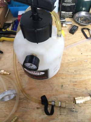

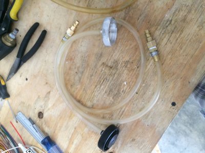

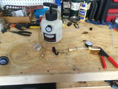

For those who have a motive power bleeder for the brakes on your car. I had an idea today to make a clutch vacuum bleeder. I bought the vacuum pump and air line connectors at harbor freight. On the motive power bleeder container. I attached an air line quick connect. And on each adapter the correct fitting. Then did the same for the vacuum pump. So I can now connect the adapter to either the motive or the vacuum pump. I tested for 5 mins and never lost any vacuum.
Works great. Just letting everyone know.
