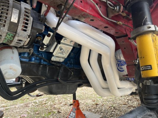

good evening team do you have any pictures where gauges,gauges autometer , oil pressure, oil temperature, and water temperature have to be connected on a coyote mustang gt 2013??? thanks you guys

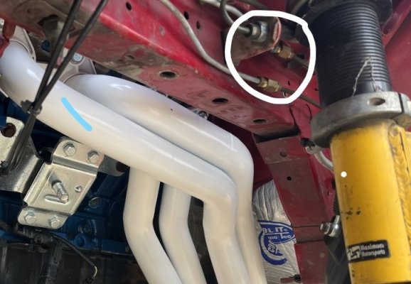

Zoom in right next to the motor mount. The coolant sensor goes in the block. You have to buy an adapter that fits the block. Oil pressure is next to it, but I’m the oil filter adapter housing. If you need to keep the stock gauge, you’ll have to make a Tee from pipe fittings so both can get pressure. I’m not entirely sure on oil temp. IMG_1081.jpeg
