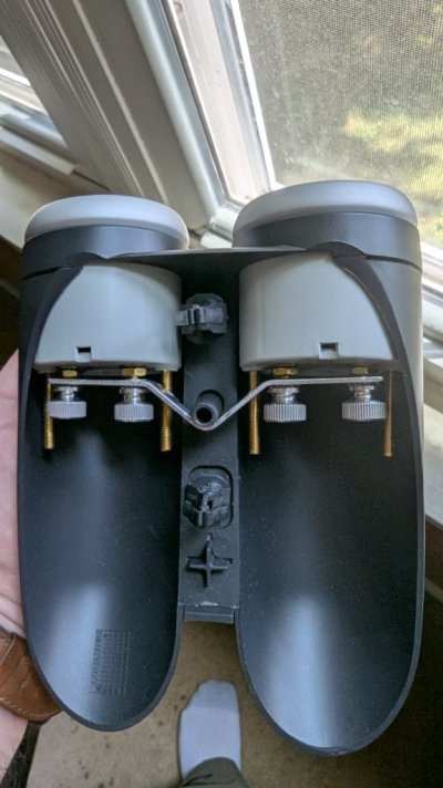

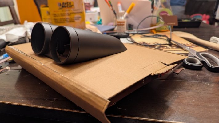

Curious if anyone else had run into this problem. I'm working on installing some Autometer sport comp gauges in a Saleen dash pod. When test fitting the gauges into the pod, I noticed the gauges hang below the bottom of the pod:
Yeah if you look at the Saleen gauges, they're definitely shorter.

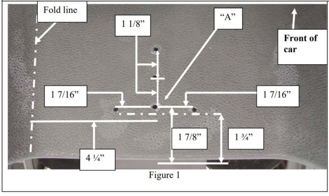

But the directions have you drill some big 1" holes right around where the back or the gauges end up, so I figure that must give some relief.

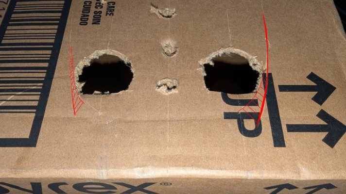

But before drilling anything I wanted to mock up the fitment on a cardboard box -- good thing I did, because the drill locations in the directions wouldn't have worked. Here's where they want you to drill:
Nnnnope.

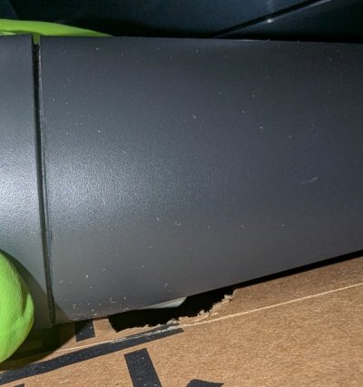

I'll save the blow by blow, but after some trial and error, this is what I ended up with. The red is the outline of where the gauge pod sits. You can see I had to hug the inside edge of the bezel. The holes started out as 1", centered 3/4" further back than called out in the directions. But then I had to embiggen them to 1 11/32" long by 1 3/16 wide
Clearance
Fitting good.
I'm going to try coming up with a better template before trying this on the real thing.

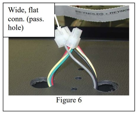

Everybody is different so, I always installed gauges in a way that I can remove them to sell the car. I would never cut holes in the dash. There are so many good glue products out there which can be removed. And I would go with the cable around the glass. The big holes are only for the connectors? I would pin it out just to need smaller holes.

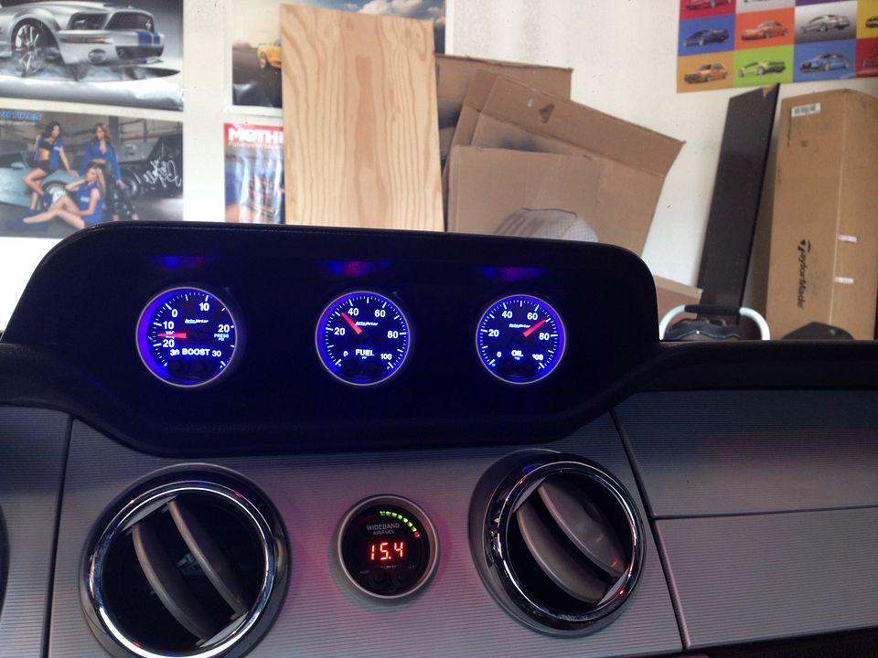

I went with the simple autometer 3-gauge pod for my Jessica. Yes I drilled a hole in the dash even though I probably could have run wires through the defrost vents.
I used to clock the my gauges (old school trick) so that all the needles pointed straight up at WOT. This way you can glance at them and see everything is ok without having to actually read them. But my current gauges you can set different colors for different ranges so I have them set to be all green when they're in their proper range for WOT operation. That way during a run I can see everything literally in the green as I make a pull.

I like the look of the double pod myself but that's a pretty sweet setup, especially with the color change. What's the blue for though?

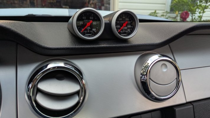

1000014338.jpgdid some more mocking up using a contour gauge to get the right curvature on the dash, then used it to get the right shape for the cut outs.
Also had to notch the bracket that holds in the gauges to get it to fit over the long posts, and had to widen the slots for the short posts that the thumb screws went on
cavero
Jun 30, 2012
912
281
NoVA
After measuring, over and over... And over again I finally got to work. Didn't have enough room to fit the drill under the glass, and even the flex shaft on the Dremel was too long on the furthest holes so I did it by hand, stepping through every bit I had up through the 5/16" needed
I traced out the template I made and finally cut out the recesses for the gauges

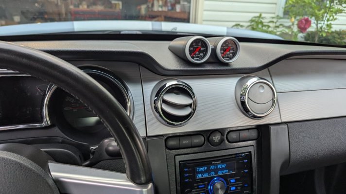

That looks great! I wonder if you could have angled them a little bit? It would probably be an issue with the curve on the dash mating with the pod if you did that.
brasil
Sep 14, 2019
459
193
Germany
I am with 07 Boss. Looks great, but I think little angled towards the driver would be a "nice to have ". Perhaps you can turn the whole assy a little bit ?
cavero
Jun 30, 2012
912
281
NoVA
Yeah I figured at least I'd mount the oil pressure closer to the driver to be easier to see. With the curve of the dash/pod, I don't know if it'd work, but then again curve is very slight so the gap might not be that bad.
I thought about after you mentioned that, instead of drilling the three mounting holes, I probably could have made two of them arcs so it could pivot. Sucks though, those cutouts I had to do for the gauges are right up against the sides of the pod so if I turned it even a little bit you'd see the cutouts poking out around the sides

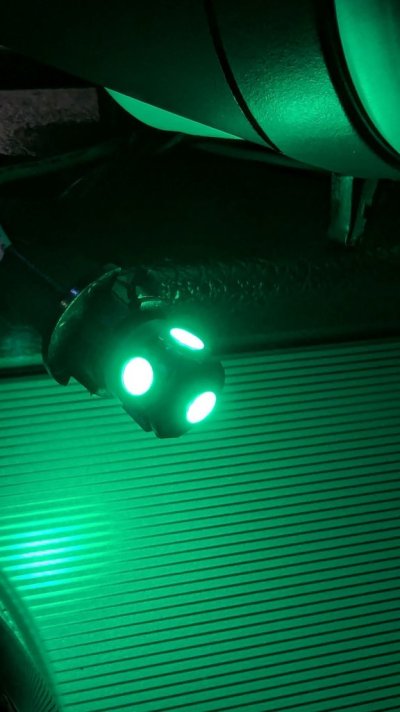

Got the lighting hooked up this weekend, HUGE thanks to this thread. I ended up splicing into the plug for where the automatic shift lever would've been.
and MAN do those incandescent bulbs suck. The only way you can read them is at full brightness, and then the housing is getting pretty hot.
This is at half brightness
And this is at full blast.
cavero
Jun 30, 2012
912
281
NoVA
Went looking around and found Autometer sells 193 size LED bulbs, almost $20 each --- yikes -- but I bought them anyway because they were dimmable and had good reviews.
cavero
Jun 30, 2012
912
281
NoVA
Compare between the two
And here they are installed, this is minimum brightness
And this is max
They're definitely dimmable and follow the brightness with dash pretty close (just a little brighter). Color wise, they're a little... mintier? Def bluer than the stock Ford green backlighting, but a not too bad. Actually matches pretty well to the color setting I've been using on the cluster lately (maybe 1, 3, 2 RGB?).
