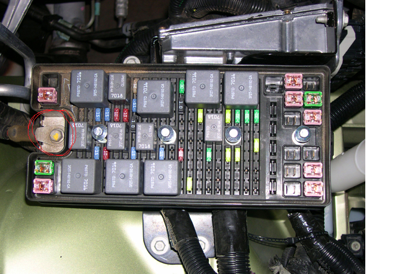

12v power: There is a hot lead on the BEC (engine bay fuse box). See pic.
Key on power: Fuses 2.8 (instrument cluster) and 2.20 (radio) at the SJB (pass side kickpanel box) are good ones. The radio gets power at key position 1 and the instrument cluster lights up at position 2 if that matters. There are lots of key on sources at the BEC too if you don't want wires coming back through the passenger side grommet.

Hey, thanks for the quick reply. The headlight switch wire info is exactly what I needed. As for the others, I was hoping someone had info on what wires I could tap that were already near the bottom of the steering column by the driver's feet? I'll run new wires from the BEC if I have to, but would rather not if there are quick and convenient ways to grab it where I need it.
EDIT: I guess I can pull lines from the passenger kick panel as you suggest . . . if there isn't a better alternative at the steering column. I don't mind splicing and soldering, if there are lines there where I need them.
