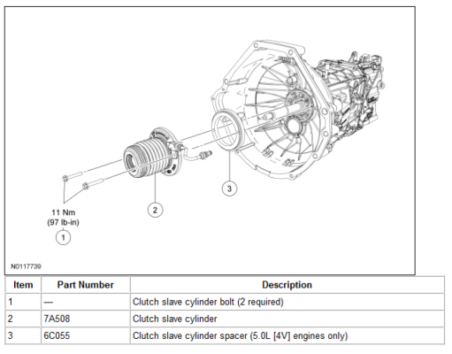

Just wanted to let you'all know that 2011-2012 MT-82 Mustangs (aa-ab cases) require a spacer between the slave cylinder / throw out bearing and the transmission case. If you need a spacer, Calimer Transmissions sells them or you can probably find used Ford OEM ones on eBay. If you are replacing your clutch with an aftermarket brand (McLeod, Exedy, etc.) you still need the spacer, it's not optional.
