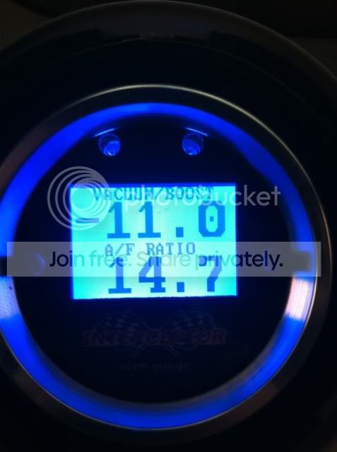

Bad ass gauges i love mine running a boost sensonr and Innovate LC-1 for A/F
That's one of the awesome things about the 2011+ 5.0's. They already have two wide-band A/F sensors. No need to buy an aftermarket sensor from what I've been told by various tuners.

LOL! Sorry brother. But for boost, I'd go with a good, aftermarket sensor and use the analog input like I would imagine you are doing.

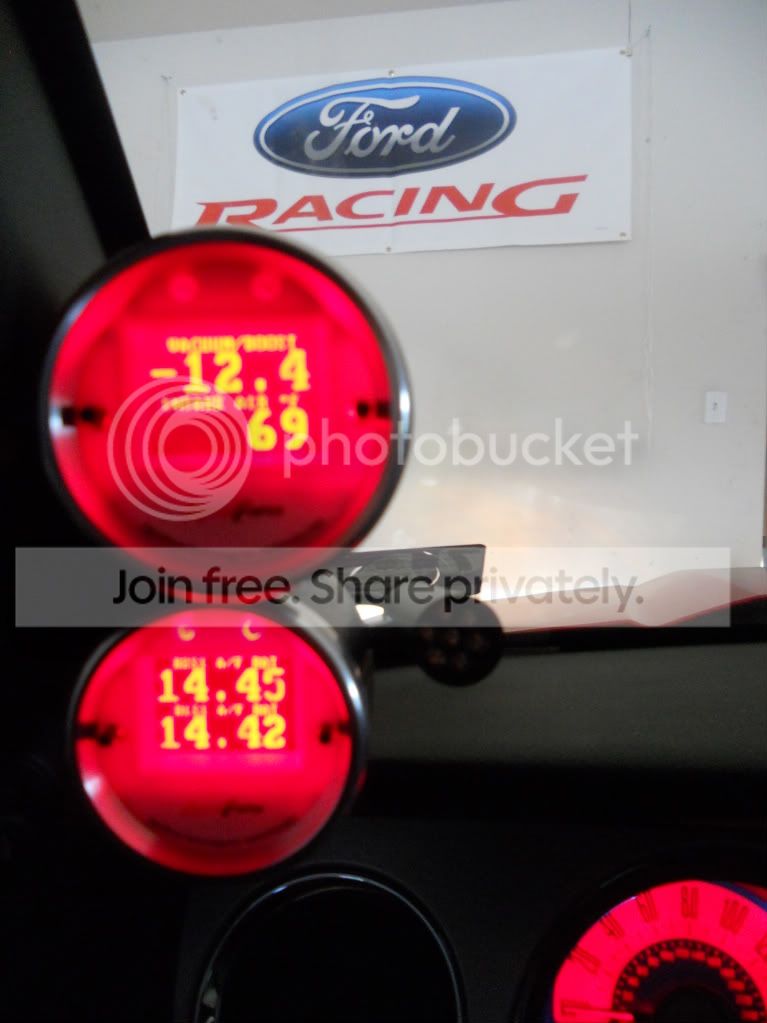

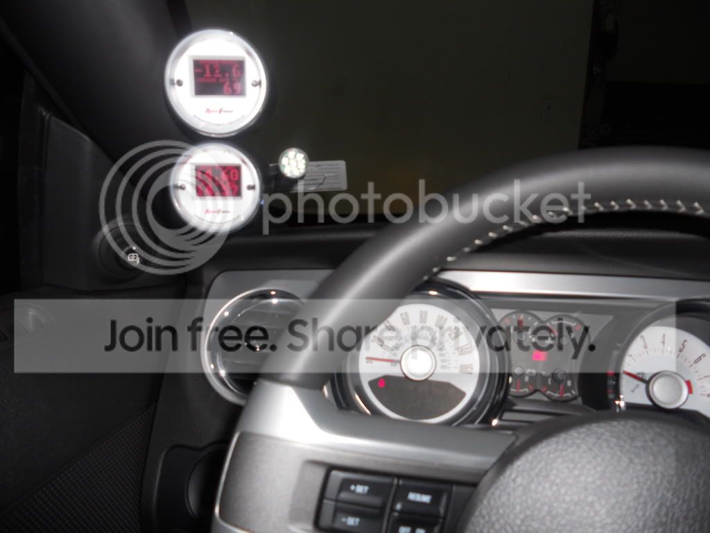

Yeah, my pictures reflect that too. I'll have to make sure I put up my shade from now on. Even when I just want to run into a store real quick, I can just sling it up there wrapped up into its little circles.
I'll get much better pictures later on when the car hasn't been sitting in the sun all morning. I let the car idle for a while trying to cool it down, but still didn't get them to completely brighten up until I got out on the road. But those pics turned out like shit from my cell phone.
One thing I've noticed is that for one, my Lund tune is pretty conservative at WOT showing 12.10 AFR on each bank. Also, when I'm under 30mph, the inlet temps stay pretty much around 140°. As soon as I get over 45mph, they drop fast. By the time I'm doing 60, the ambient will show 90° and the inlet temp is 91°. So when I'm cruising at 55 or higher, the inlet temps are just a degree or two over ambient. Come to a stop light and sit for a minute and it will go up to 110°. Sit for three or four and it will be 135+. Haven't seen higher than 158° even after the car idled for 10 minutes.

How come you mounted your crooked?

They probably won't stay that way, but with how tall I am, I lean the seat back a bit and they are a bit easier to read with my sunglasses on. I'll probably end up adjusting them five more times before I get them right where I want them.
