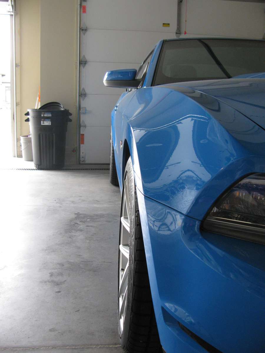

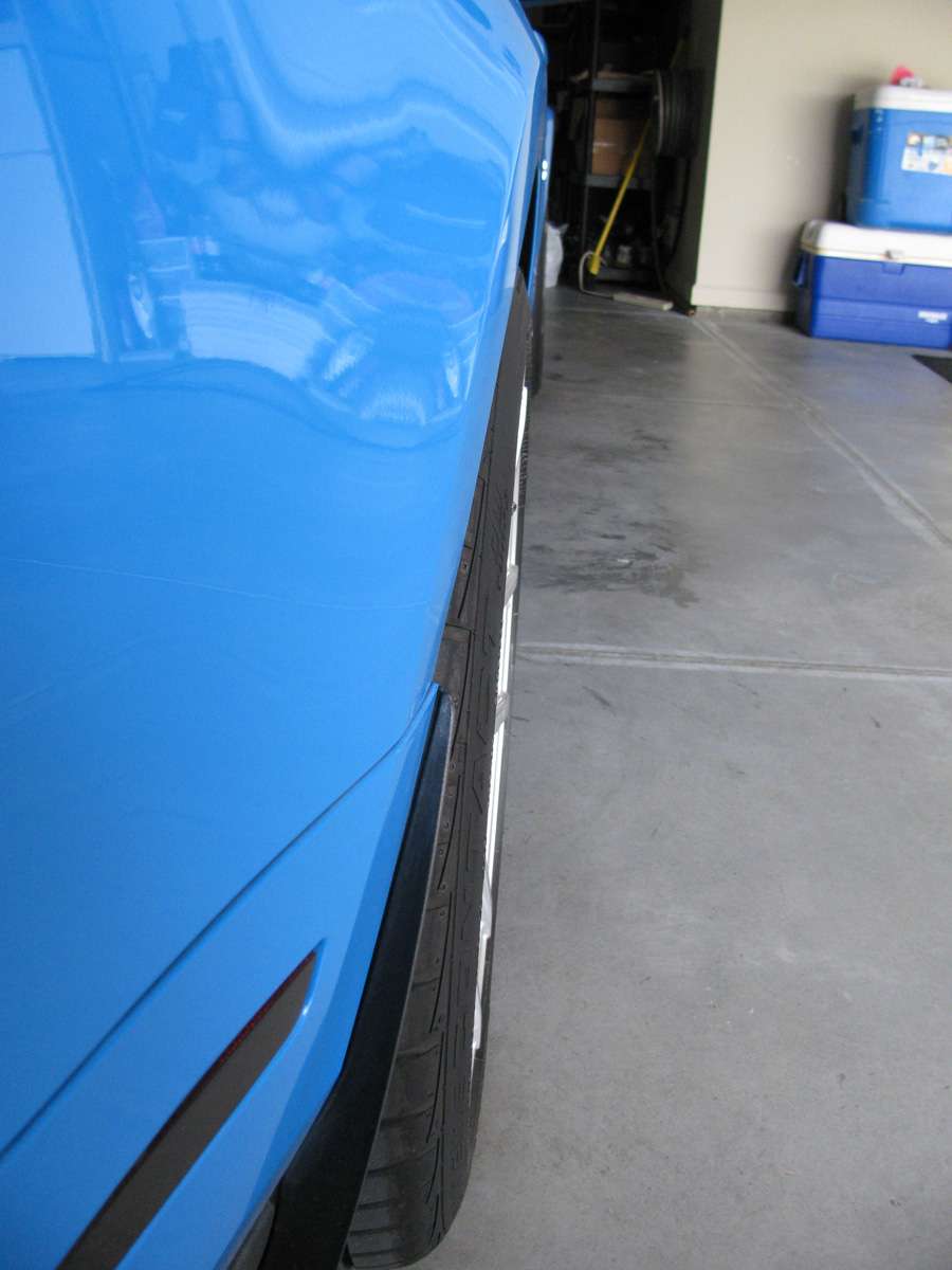

I have been searching and have found many people in the slammed threads discussing their various wheels and backspaces but didn't really see what I was looking for directly from the front or rear. I am currently running the track pack wheels with factory Brembo's. Current size is 19x9 and I am running 285/35/19 Conti DW's on all four corners. The fronts currently have 5mm spacers on them so they are obviously closer to the fender than stock...

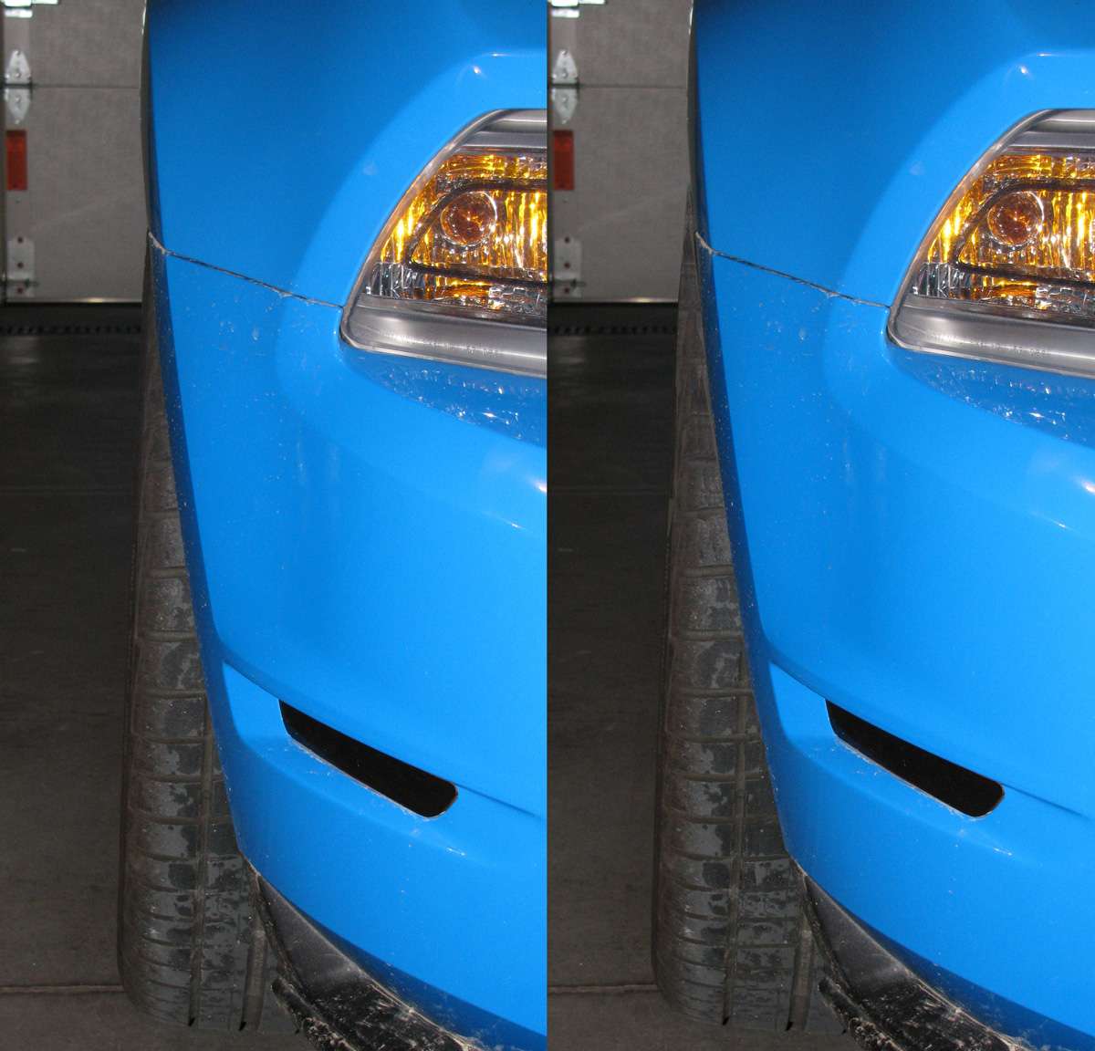

I am looking at moving to a 19x10 and need assistance in figuring out what would be the proper backspace. I am obviously not going for the stretched look with a huge rim and small tires and I don't want the wheel/tire to stick out of the wheel well at all. Car was dropped 1" up front and 1.5" in the back so not slammed by any means. Below are pictures of the car as it currently sits and a photoshop of what I am looking forward next to it to the right. basically I would like the tire about 3/8"-1/2" in the rear and about a 1/2" in the front but can offset a smaller amount with the spacers. Messing with online calculators it appears a +30 to +35mm would work up front just about perfectly but don't know about the rear...
May have been covered elsewhere but I was not able to find it so any help is appreciated!

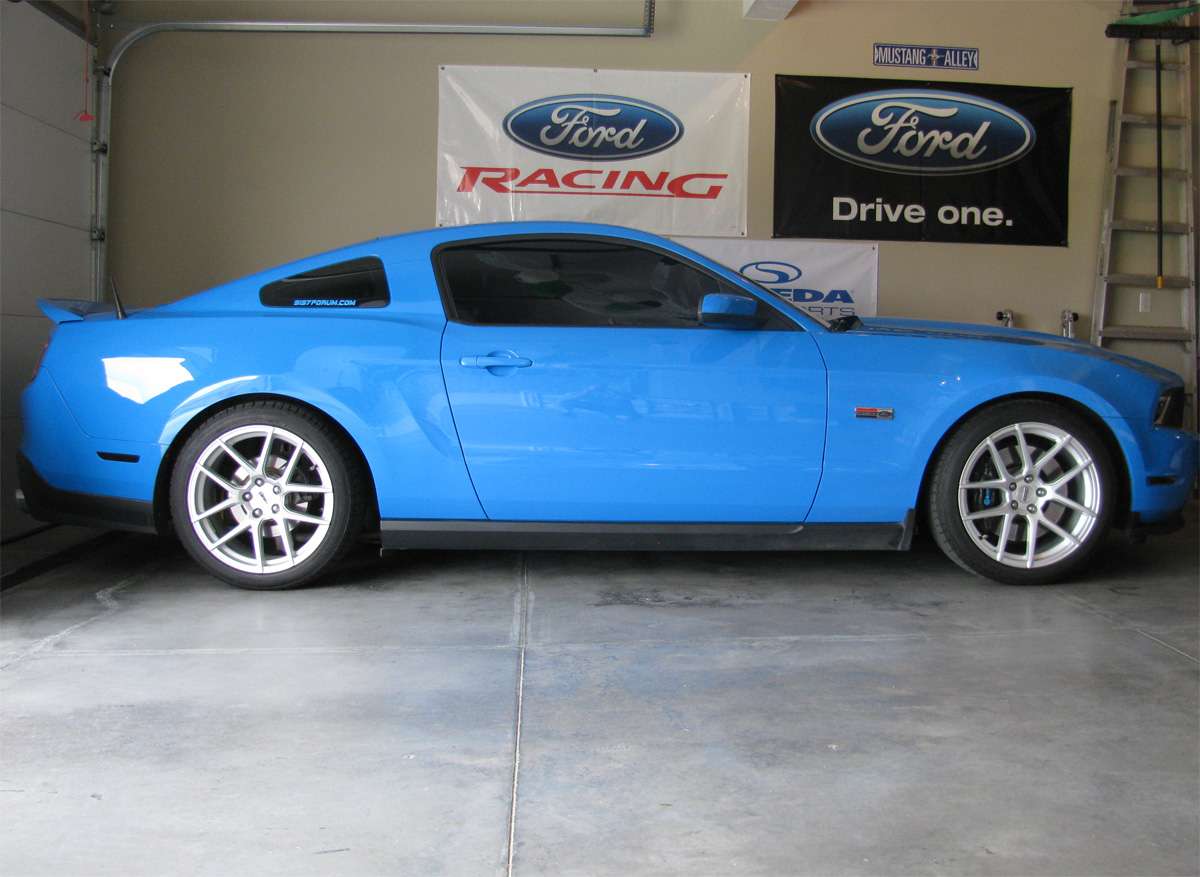

Photoshopped some pics of what they will look like... should hopefully get them installed tomorrow or Wednesday.

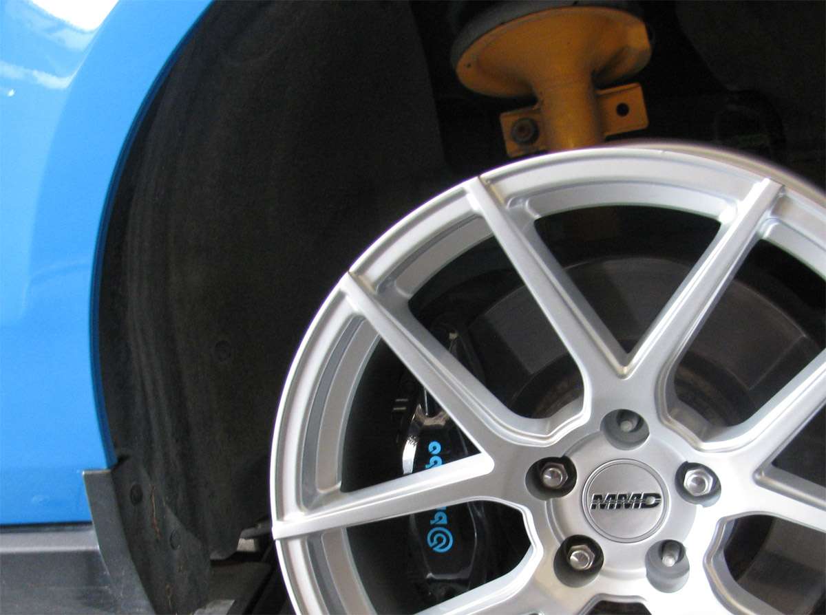

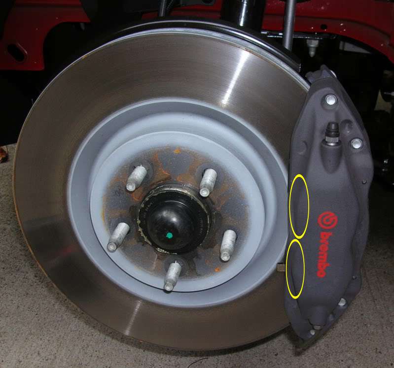

Put the wheel on and looked at it every way I could think of and I think I will be okay. IF it rubs the caliper it will be on the front inside edge of the caliper:

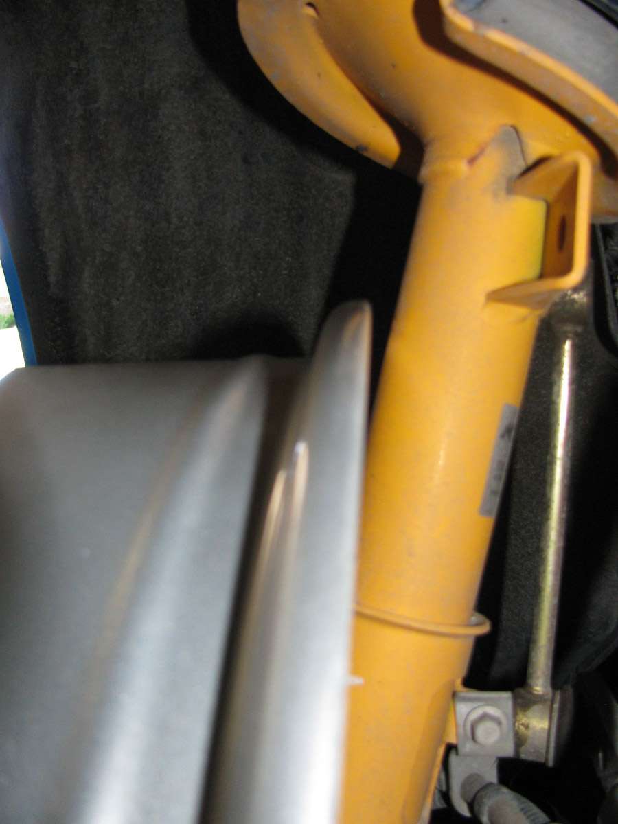

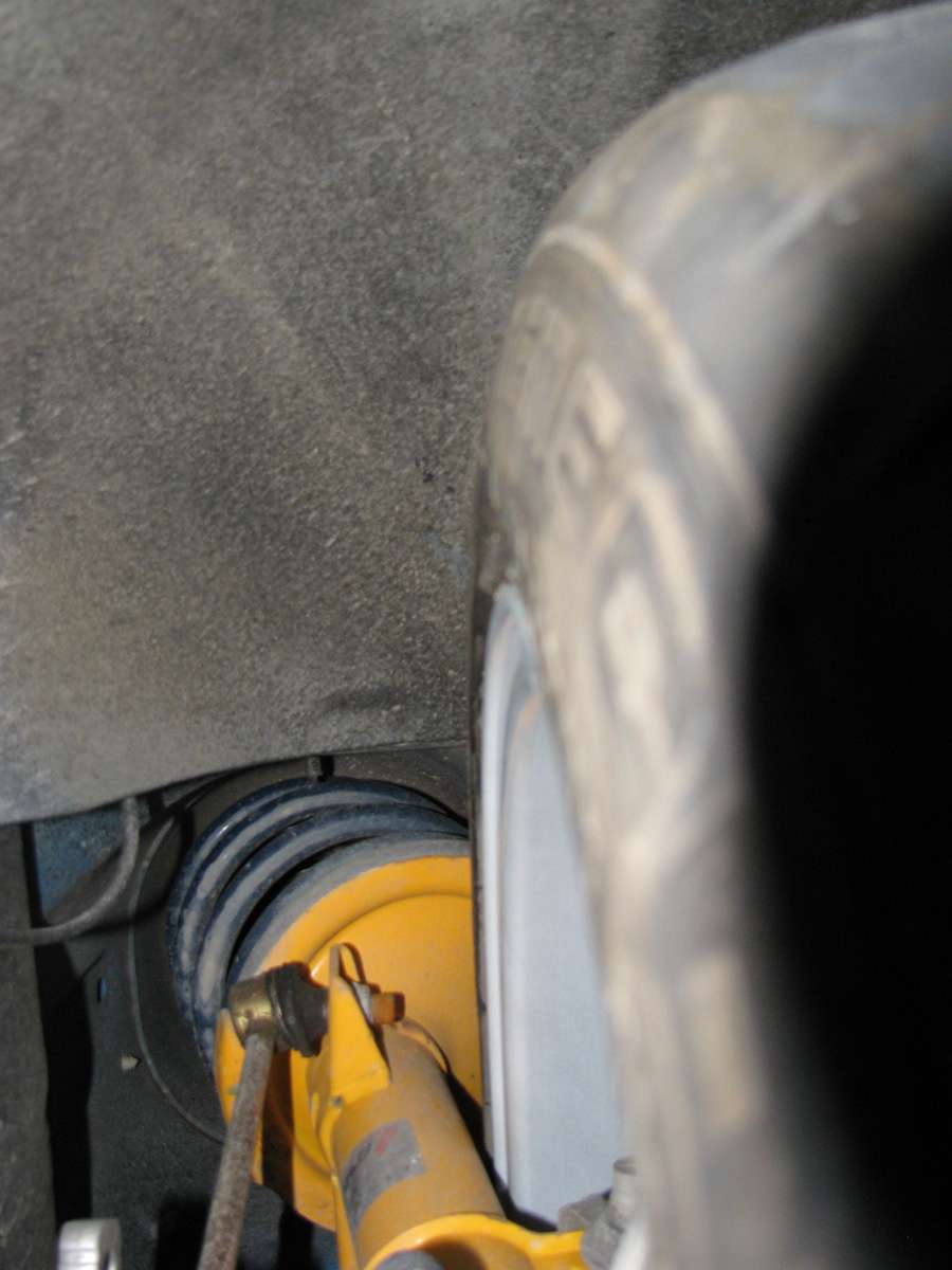

The back of the wheel is pretty close to the strut but I think it will work. Hoping to have it work with no spacers or if I have to have them, I want to only use a 1/8" or smaller... not sure if that is feasible but my goal.

Just fyi...you don't need a ton of space between the wheel and strut. Pretty much all of the tire sidewall deformation that happens when cornering is at the road surface, not the top of the wheel. I use to run my mustang on track with a few millimeters of clearance with the strut.
BUT- make sure you aren't rubbing on the swaybar endlink stud. That could be disastrous. Easy fix- yank the endlink and bandsaw one of the studs a little shorter.

Based on the pics I think I am good... I will certainly verify, thanks for the heads up. In the second pic it doesn't look like the bolt is long enough to go past the strut so hopeful I won't have to do any grinding.

Everything fit and the offsets were perfect!!!!
The wheels are a gnat's ball hair away from the caliper (see last pic) but I don't hear or see any rubbing. have about an 1/8" between the wheel and strut and about the same (maybe a touch less) between the tire and strut. The car seems to drive nicer... I know I am probably dreaming that but it just seems less harsh and doesn't seem to wander as much. Maybe it is losing the crappy spacers on the front, maybe it is the lower wheel weight, or maybe it is the proper wheel width for the tires... I don't know but it feels good!
