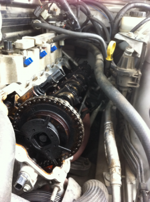

Pulled the Valve cover on the drivers side and I noticed I have some deposit build up in there. It will wipe clean but its not what I wanted to see when cracking it open.
Things I noticed-
Low side of the timing chain was loose -the high side was tight. Is this normal or should both sided be tight?
I have vents on top of the valve covers to release pressure. I noticed that some of the kick back has made its way to the spark plug on the first 2 cylinders. (I have a catch that I will install to clear this problem up. It would be nice if all this situation was is a fouled plug... but I doubt it. This could be the reason for the misfire code along with the p0345 code when all this started.
All rockers/ cam looked good, everything in its place and score free!
Once I get things back together I will run some seafoam through the oil for a few miles and change it out a couple of times to clean out the deposits.

That looks horrible in there as far as sludge and whatnot. Something is definitely going on in there. I have used Mobil 1 oil in my car from the beginning, changing it 3-5k miles before I had the engine built and now 3k or less depending on how much racing I do.
Here's a picture of mine from this winter when I was changing out my valve springs and whatnot. My cam sprockets had around 115k miles on them in this picture.

That picture looks rough. How many miles are on the engine and what kind of oil are you using?

Yeah it's looking rough! I put less than 10 k a year on her up here due to the winter. I change the oil at the end of winter and end of our summer. The car sat for 7 months while I deployed and this started about a month after I got back. I'll be pulling the other cover tomorrow to look for damage.
I'd there a chemical or process I can do to clean this out? I heard of putting ATF in the oil for a couple of hours to help clean it out, same with seafoam.
