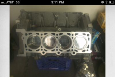

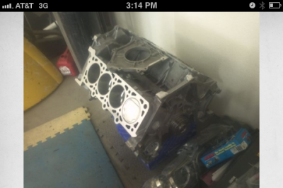

here is an update on the motor, its all put together now jst need to get it in and order a tune, gonna go with jdm for the start up tune, and go from there

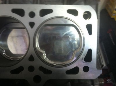

How far are the pistons in the hole at tdc?
