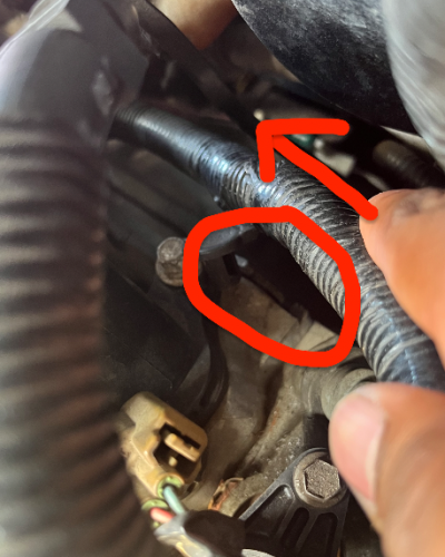

The levers that connect the charge motion motor to the actual CMCV/IMRC valves have been taken off and consequently throw codes, and I've fixed all the other codes except for the P0198 circuit A. No idea where the oil temp sensor even is on the 2006s and could not find it underneath.

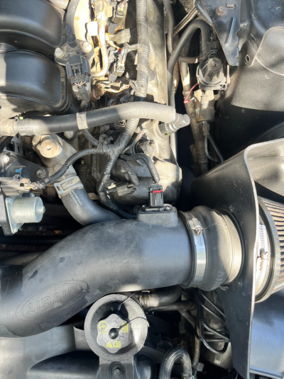

Lito will make the car run way better like night and day. Prioritize that above all else given your mods. What Airraid CAI do you have? If it’s the one with a large MAF housing, do not run the car without a tune. Your MAF transfer function will be off in the tune.

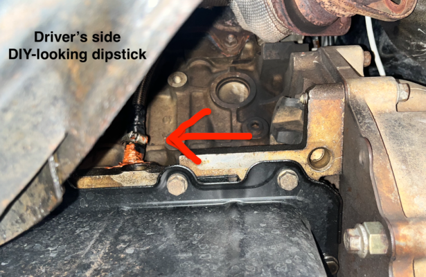

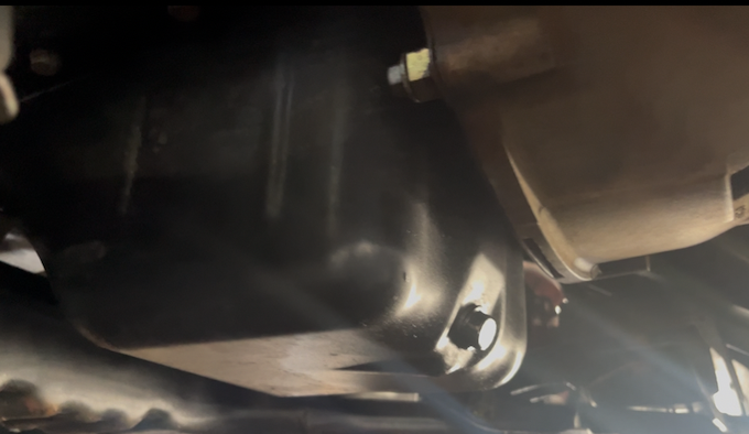

The 06 oil temp sensor should be on the driver side of the oil pan, visible from underneath. 07+ had them removed. If you don’t have one in the pan, your oil pan (or motor) may have been swapped at some point.

As for the oil temp sensor, I guess they swapped the oil pan; the original dipstick is missing as well and is clearly a DIY fabrication. I'm hoping it's not too important? I don't drive the car hard (at least not yet)
Driver's side:

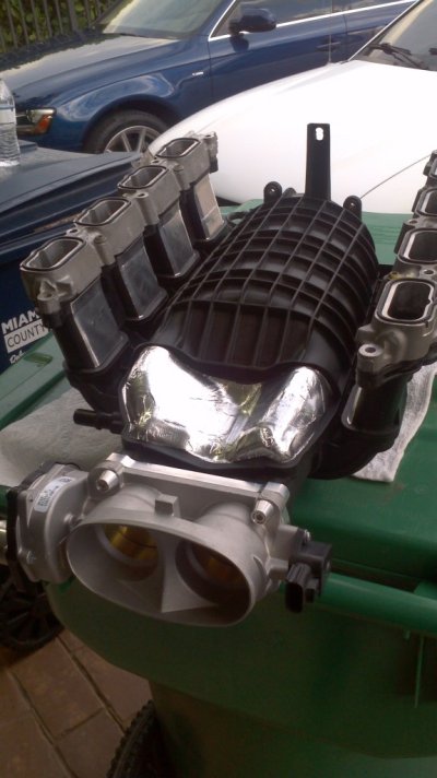

Last thing, the CMCV; the valves are there. No delete plates. But I can freely move the little ends with my hand; I've kept them open so they essentially function like delete plates. Here's two pictures, one in the closed and one in the open position:
I was thinking I'd use something to lock them open temporarily until I decide to get delete plates or try to fix the cmcv motor. I've seen them made for the s550 cmcvs: https://www.beefcakeracing.com/spma...6Zrb-vDwiSiRut_oaVh4N1rCVgo4DfxCXZjfj0JywQ0AA
This is my MAF housing in the Airaid:

You can save some money and make your existing CMCV plates deleted with hi-temp epoxy. Super easy to do...

Your primary issue here is the MAF transfer function being under scaled in your tune for the Air raid CAI. The car is taking in a lot more air than it expects with the stock tune. You need to hold off on driving until you get that resolved. A close second is you HAVE to do what JC SSP suggested with the CMCVs. Trying to just hold the valves open is asking for trouble and making your own CMDPs is really easy.

Thank you all for the advice! Did not realize how much support I could get from the forums. Found the cmdpguide pdf online and will make my own delete plates as suggested, then tune.

Hey folks it's been a minute, but I took all of your advice and have since deleted my CMCVs as JC SSP recommended with steelstik and a dremel. Cleaned out all the intake components and paid Lito for a cammed tune.
