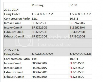

Let’s talk about this GEN2 F150 firing order...Everything I read said the GEN2 exhaust cams were interchangeable. I had to change to my GEN1 intake cams but could use the F150 GEN2 exhaust cams.

Gen 1 and Gen 2 mustangs have the same firing order 1-5-4-8-6-3-7-2
Gen 1 and Gen 2 F150's have different firing orders (Gen 1: 1-5-4-8-6-3-7-2, Gen 2: 1-3-7-2-6-5-4-8)
It will run exactly as you describe if you have have something with the wrong firing order.
Cylinders 1 and 6 have the correct timing and are running. 3-7-2-5-4-8 are on the intake stroke and exhaust stroke at the same time with your cam combination.
Pull a vale cover and watch cylinder 1 vs cylinder 2 as to when the intake valves and exhaust valves open. Cylinder 1 will open the intake, take a full revolution, and then open the exhaust. Cylinder 2 will open the intake and the exhaust will start opening probably just over a 1/4 turn later.
Good news is that because the cylinders that changed in the firing order are at TDC at the same time, there should not be any PTV contact by having the wrong exhaust cams in.

Holy shit! I did so much research on this too. Well, I guess it’s time to swap exhaust cams and then try it all over again. Thank you very much for the help and insight. I’ll update as soon as I get everything swapped over.

I just confirmed the part numbers of the cams that are installed.
Left
Intake BR3E-6A271-EA
Exhaust FL3E-6A273-GA
Right
Intake BR3E-6A270-EA
Exhaust FL3E-6A272-GA

If that's the case, all Gen II trucks need Gen I cams both intake and exhaust to run.

She’s alive and running on all 8!!! I was getting so frustrated!! Thank you everyone for the help and guidance. @RED09GT I couldn’t have done it without your help! Now I just need to finish everything else up (again) and I can take it for a rip.

Yes. I did a bunch of research and found several sites and even YouTube videos that had GEN2 engines with GEN1 intake cams (because of the timing components) and using GEN2 exhaust cams so that was my plan. Unfortunately what I failed to learn was that the F150 GEN2’s have a different firing order. So while you can run GEN2 mustang exhaust cams, you can’t run GEN2 F150 cams.
Live and learn I guess. All this BS over just trying to take advantage of an extra 1mm of lift.
