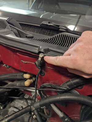

I'm not familiar with the 2011+ cars but the 05-09 have a ground from the LHS cylinder head to the firewall as well as the one on the passenger side motor mount.

This has the passenger side motor mount one but I'm not aware of one on the driver side cylinder head. It's definitely worth a look. Honestly, I'm hoping it's just something this stupid.

I just looked and there isn’t a ground there. I don’t see any loose wires anywhere either. I have another intake I’m going to throw on there to see what happens.

I do remember taking that off and I just looked and it’s missing. Now, I just have to find it, lol. If this fixes this problem you are a genius on a whole new level!
