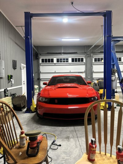

Heres a pic of my first S197 i just picked it up with 78,500 miles, flowmasters seem to be the only mod
