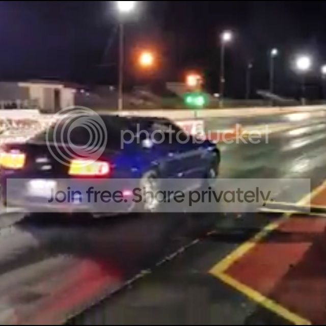

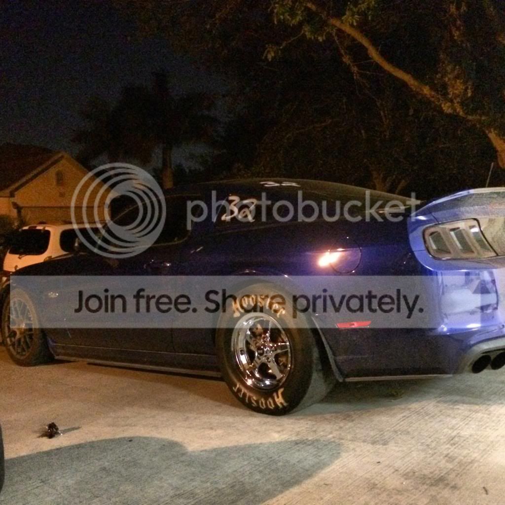

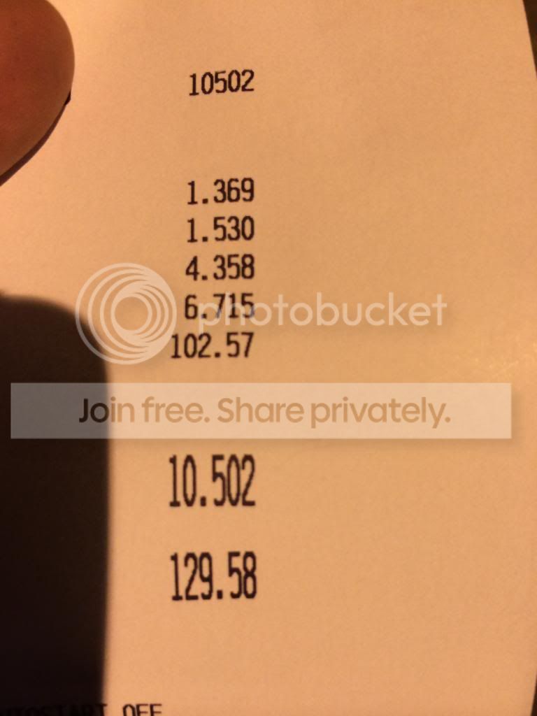

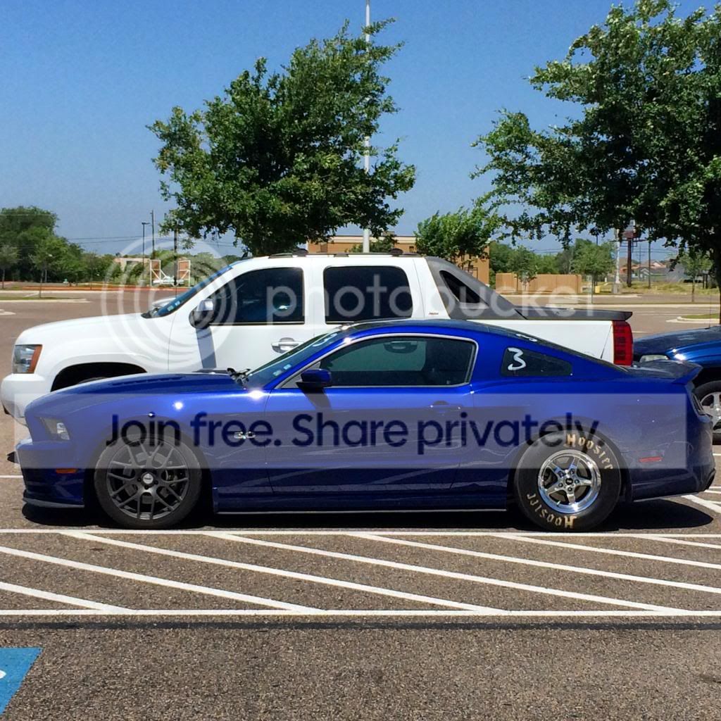

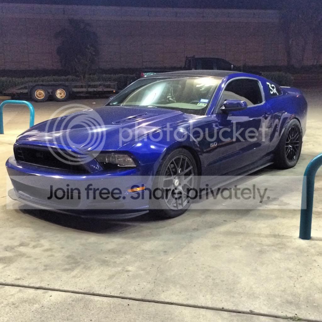

I finally got my 14' to run in the mid 10's! This Friday on 28" Hoosier slicks and 19's up front I went 10.50@129 with a 1.53 60' and 6.7@102 8th. Car has a paxton with a torque booster set up at 10 psi, an orx, and a circle d 3c 245mm converter on 93 octane. It is experiencing knock up top and pulled timing to 13 degrees. I'm gonna get that sorted out but I also want to change my suspension set up. I currently have steeda billet lcas, bmr adjustable phb, and bmr springs. I ran without a rear sway bar and will be reinstalling the stock one. I'm thinking of an adjustable Uca, lca relocation brackets, front struts, and adjustable rear shocks for now. I was looking at bmr pieces for the brackets and control arm and either the Viking double adjustables, qa1 singles, or strange s6008lm for the rear. The front I'm absolutely lost lol. I was thinking of s6009lm front struts. How would this set up drive? It is my DD and driveability matters and I occasionally have a little fun on the expressway as well as track fun. I was also thinking of a radiator support delete but the version that retains the front sway bar.
Any and all advice is appreciated! The road to 10's starts now! Here are some pics.
