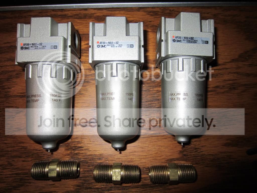

So they found 3 leaks before the manifold...mainly around the moisture separators...when fixing the leak they cracked one...ugh! Gotta order another.

Oh well, I just ordered another separator. I have one installed that's leak free and it between the tank and the manifold. The one that cracked was between the compressor and the tank. I just ordered another one but for right now it's installed without the separator with no leaks :)

Yea if your water traps are plastic don't just torque them down. Gotta use the liquid Teflon to fill all the gaps and just get it snug

The Air Lift /SMC water traps I used were metal.
So were mine, I used the 1/4 Jeremy suggested, part # 21011.
http://www.airliftperformance.com/product/21011/
supposedly it kept leaking, they used teflon, plumbers dope, etc and it wouldn't seal. So they tried to tighten the fitting a bit more that it actually cracked...

Holy hell. Did they tighten it with a pipe wrench and cheater bar. And Thor's hammer? Lol

definitely had me scratching my head....fuckers cost me another $45...lol

yea i just used tape on everything, but i also didnt torque the fuck out of it all.
just wrap the male fittings a few times and get them snug, shouldnt leak at all
