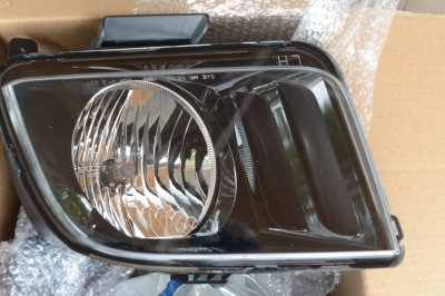

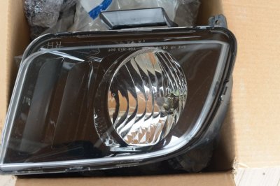

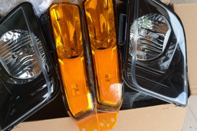

I have a the ones off my '07 that I took off when I did the GT500 nose. They were changed about 2 or 3K after I bought it new. They are the halogen ones. If you need them make me an offer and I can send them right out. They are packaged in the GT500 head lite boxes.

Got any pics? Scale of 1-10, what would you grade them?

I would say they are an 8 or 9 being really good. I don't know if you can see it in the pics but they do have a few tiny stone chips. I'll also throw in the yellow lenses. Hows 75.00 + shipping for the pair?

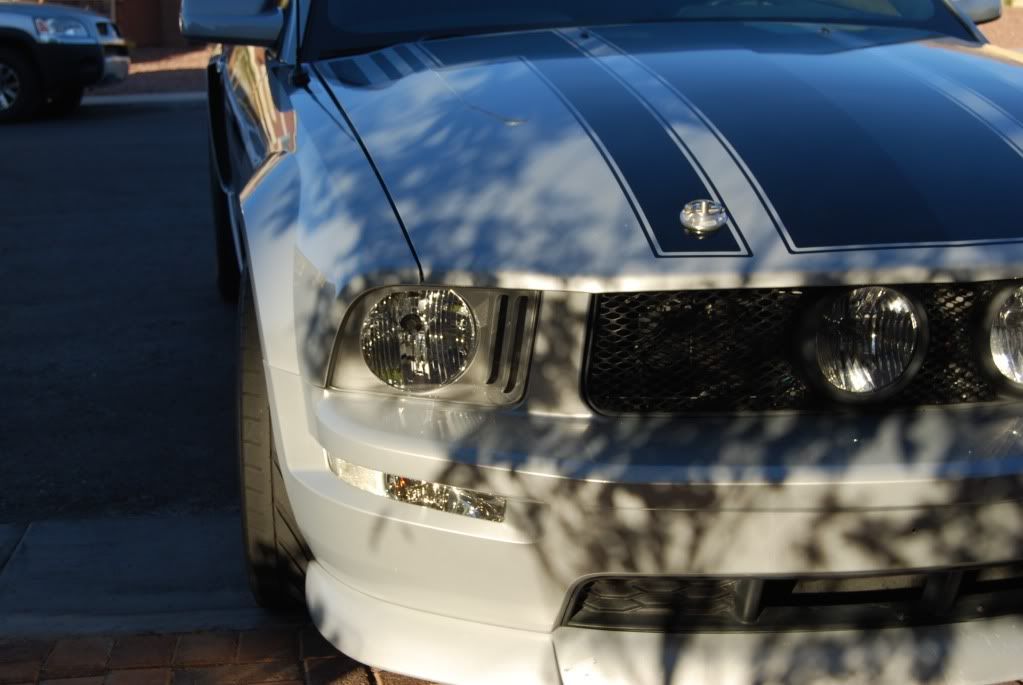

I'm not familiar with the HID housings but I took my headlights apart twice. One time was a failure and the second worked fine. I believe I was told that there wee two manufacturers for the lights and they used different sealant. One came apart pretty easily with heat and a good blade,hobby knife. The other one I ended up cracking the lens. Anyways, if you want to keep your HID housings and change just the cover you might as well see if you can dismantle them. I mean if you are going to replace them you might as well try.
Here are mine after I painted the buckets and re-assembled them.

Man, that looks so much better color matched. Did you use the oven method or heat gun?
