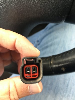

Ford does make a wiring pigtail for that, I just had to do both on the front of mine. I’ll get you the part number for it when I get to the garage this morning.
ShelbyX3
Jan 10, 2016
15
Part # for the pigtail is 3U2Z-14S411-RPC... it isnt cheap though
Thanks for the photo and the Part #. I figured it wouldn't be cheap. The smaller and more plastic in the part the higher the price, especially if it has anything to do with electric. I hit up a junkyard over the weekend and found a car with the drivers side intact so I grabbed it and hope they are not side specific. I'll know for sure as the front end is my project for the Thanksgiving weekend.
