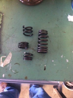

While parking my car yesterday, I had a special moment and released the clutch in a parking spot while in gear and while running. So car shuts off. I go into store and then return. Car starts fine and drives fine for about an 1/8 of a mile and starts to sound rough as well as very low idle when coming to a stop. Once I get to a parking lot to check my car it now sounds like it has heavy lope cams. The motor sounds like a misfire. The cab of the car reeks of fuel but no fuel leak present.
Here is a list of what we checked. Maybe someone has another idea.
* I have checked all spark plugs as well as tested all coil packs.
* I reverted the tune back to stock then back to aftermarket.
* Car does not have CEL, even under stock tune(vehicle barely runs on stock tune) no CEL present.
* Spark plugs have less then 20k miles and were swapped for one piece aftermarket ones
* Inline fuel filter has about 20k miles
* I have never had any mechanical problems with this car.
Mods done to car: Off road x-pipe, JLT intake with SCT Brenspeed 93 octane tune.
Our current plan is to pull out injectors and flow test them as well as clean fuel system. My car only has 62k miles and is barely driven now. More of a garage queen these days.
Is there a slight chance when parked I released the clutch while in gear and running that I jumped my timing somehow? I have never heard of a motor doing that but it never hurts to ask.
