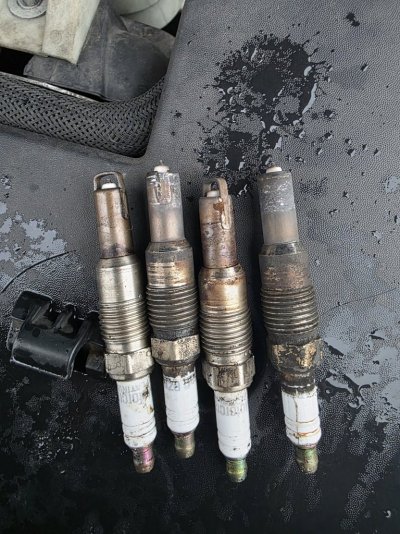

Pulled the plugs and not only were they barely hand tight but my 2 problem cylinders have the end of the spark plug missing (electrode i think?) Can i just get a set of new plugs and run it or should i worry about where that electrode ended up? Sense ive already driven the car around for this long I would imagine if any damage was going to be done its already happened.1000010501.jpg

Pulled the plugs and not only were they barely hand tight but my 2 problem cylinders have the end of the spark plug missing (electrode i think?) Can i just get a set of new plugs and run it or should i worry about where that electrode ended up? Sense ive already driven the car around for this long I would imagine if any damage was going to be done its already happened.View attachment 113854
Wouldn’t worry about it. If they were lose, the electrode probably burnt off and even if it broke off in one big piece, it likely went out the exhaust.
Happened to me in my prior 3v and after a plug swap, car ran harder than ever.

You got already the latest spark plug revision. (I personally don't like the weld on electrode style plug. Welds are always a weak point.)
