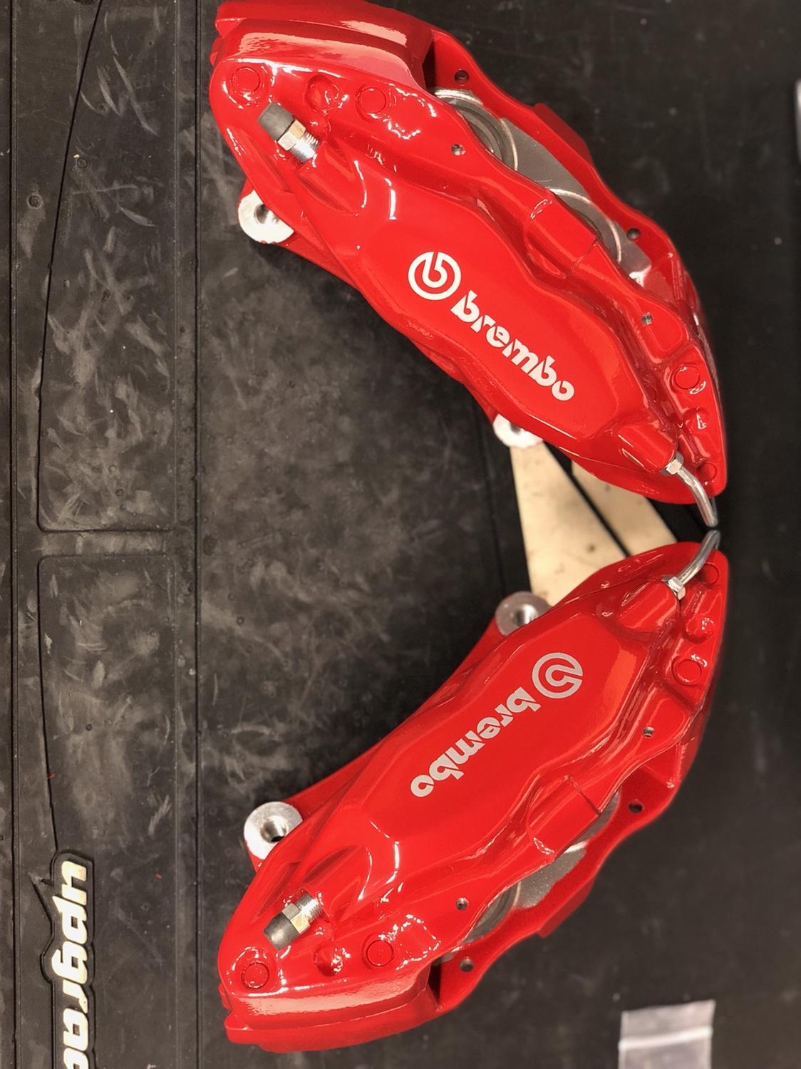

Ended up powder coating them with no clear coat. Got new Centric rotors front and rear, extreme Z26 ceramic pads front and rear, and Russell stainless lines. Now just have to find the time to install them.

They look awesome! I keep getting told powder coating is expensive but never told what expensive is, would you mind saying how much you paid for them to get powder coated?
jlmotox
Sep 3, 2014
339
40
Thanks! Only ended up charging me $75!
I sanded and shaved them smooth, took forever but worth it! also took the pistons and seals out and cleaned them really well before dropping them off. Decals were $8 on eBay...
