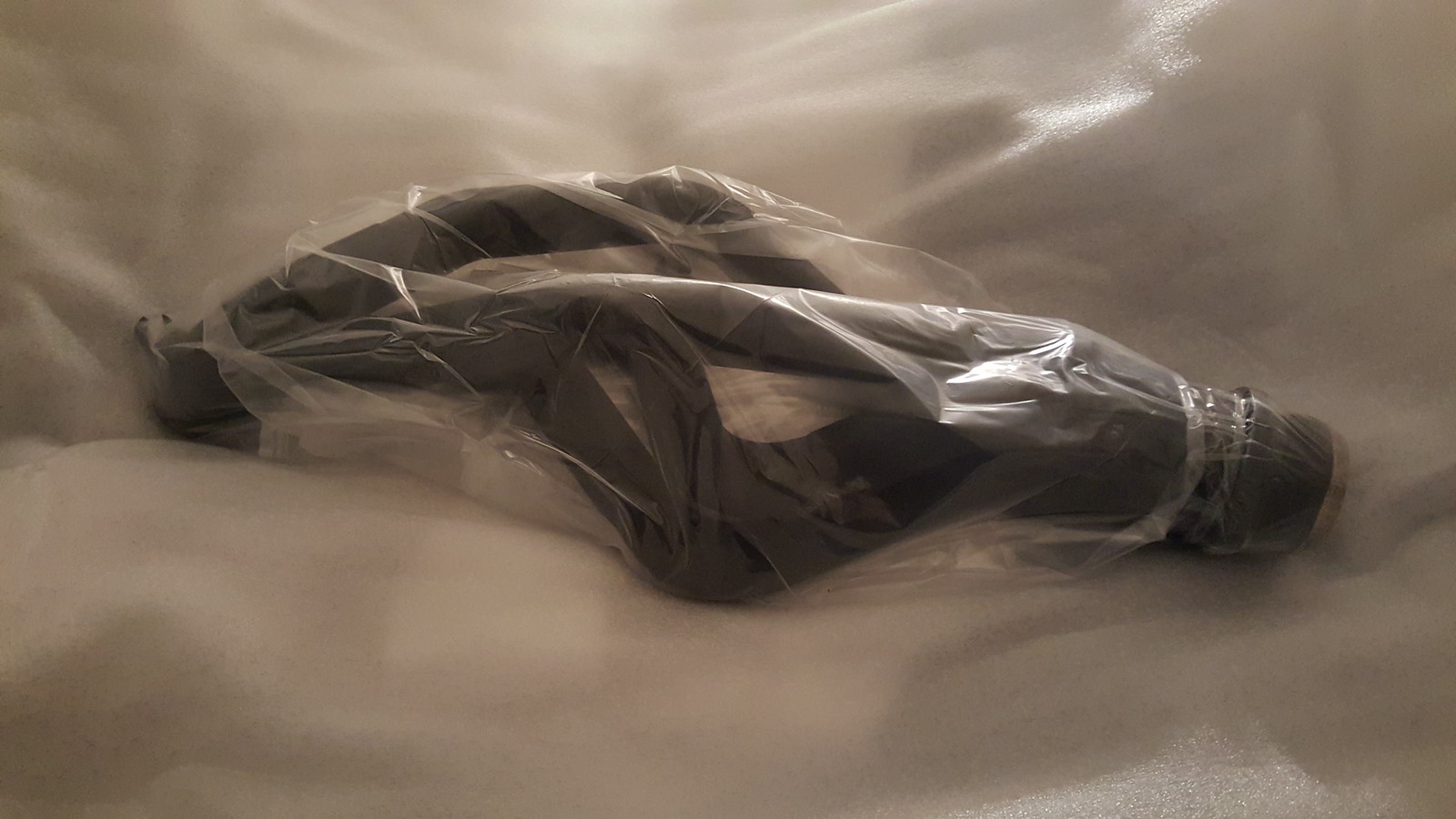

So a few months back I ended up wrapping the headers in DEI Titanium header wrap and it was a bit of a pain in the butt since I have never done anything like that before and my stainless steel tie wraps wouldn't fit all the way around the collector and I didn't think they came out all that great. There were some spots that weren't wrapped due to the tight gaps between each pipe so I decided to take them off and wrap them and ceramic coat them since I now had plenty of time to do that.
I ended up contacting Jet-Hot and was looking for a ceramic coating that would be able to handle 30 minutes of on track session without skipping a beat. Since the primary tubes are so close to the heads I wanted to try and keep them as cool as possible considering their close proximity to the headers. Their sales rep Dustin contacted me within an hour and sent me some product info about their Extreme 2500 Ceramic Coating finish which is below:
Extreme 2500 ceramic coating is a blend of full ceramic oxides that provide an insulative barrier from the conductive transfer of heat. The coating also provides excellent corrosion protection from both salt spray and chemical attack due to the inert materials that are fused together creating the coating film. The corrosion protections provides the ability for a blanket or wrap to be used in conjunction with this coating without the negative effects of corrosion by entrapped moisture between the wrap and the metal substrate.
This type of coating is typically used in applications where ceramic-metallic hybrid coatings will not operate. Applications with temperatures above 1300F benefit from this coating to reduce the external skin temperature. However even lower temperature applications can benefit from the low thermal conductivity of this coating.
Extreme 2500 coating is applied to mild steel, low carbon steel, stainless steel, nickel alloys, ductile, and gray cast iron.
The application method utilizes flame spray equipment to deliver the product to the external part surfaces requiring coating. Multiple layers can be applied achieving a maximum thickness near 0.013” (0.33mm).
This coating can only be applied to line of sight exterior surfaces due to the equipment size limitations and extreme heat at the gun nozzle. Care must be exercised to ensure that temperatures do not exceed 1000F during application.
Where this coating is a full ceramic, it is susceptible to cracking when applied beyond 0.07” (0.178mm).
Product Data: Materials: Yttrium stabilized zirconium and magnesium Volatile Organic Content: None
Dry Film Thickness range: 6 to 13 mils (0.006-0.013”) or (0.15-.33mm)
Service Temperature: >2500F (1371C) continuous
Corrosion resistance B-117 salt spray: >10,000 hours
Thermal shock 1000F to 70F: No change in coating properties
Thermal Conductivity (ASTM D5470): 0.07 to 0.12 W/m*K
I mean I am no expert about Ceramic coatings so when I went to go ahead and look at what the coating does beyond what Dustin sent over to me I found that this is the level of coating that they would recommend on supercharged and turbo charged applications due to the high amounts of heat that these systems generate. The coating itself can withstand up to 4,200 degree Fahrenheit temperatures and actually insulates the pipes so that there is almost no heat radiation from the headers. If you have ever opened the hood of your 5.0 and felt the blast of hot air smack you, you would know this will be a good thing. I figured that the coating having the ability to withstand these kind of temperatures and keeping things under the hood of the car nice and cool while keeping the exhaust gases nice and toasty I was ok to spend the ~$750 for the coating plus shipping.
When I got them back holy schnikes dude! The box I received them in was bigger and the headers were packed better than they were from Kooks. I haven't taken them out of the bags yet, but the finish is black and has a gritty texture to it. You can get them top coated with another one of their finishes if you would like to. I chose not to since you can see the bones on my piggy bank.
