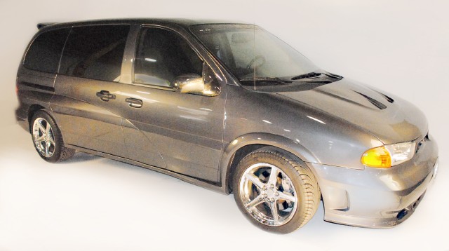

Here's a unique choice. Saleen made this one-of-a-kind SC'd Windstar for Tim Allen to go to the Emmys in back in the 90s. Heard Steve Saleen say it was one of his biggest regrets. :roflsquared:

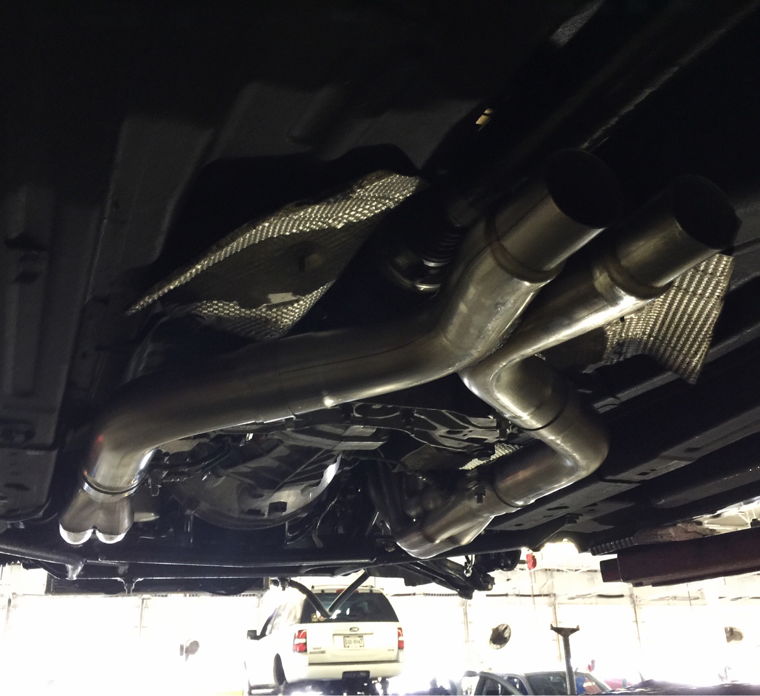

Made good progress today in the 4 short hours I had to work on the car.
Transmission hooked up
Driveshaft hooked up
Midpipe mocked up and installed
Hooked up all the misc hoses, and wiring in the engine bay.
Installed my stock brakes (for the time being - upgrading to 15" Brembos )
Only pic I snapped - the header fitment makes me super happy.
Have only a few things left before I fire it up and get it to the dyno.
Fill fluids
Bleed brakes
Remove factory bump stop brackets
Install OTA's and mufflers
Install VMP Voltage boosters
Install TB and intake (would have done it today but missing a TB gasket).
