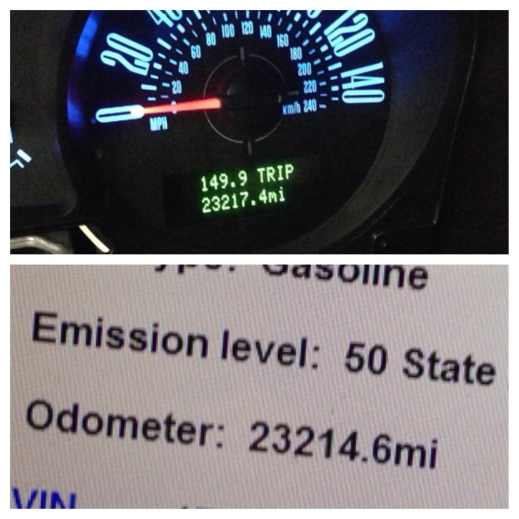

Now, this is the craziest part of the build I've seen yet.
Look at the actual chassis mileage of my car versus the GT500 ECU
GallopingFord
I'm Cam - Mr. Indecisive
Sep 5, 2010
15,369
10
Northern Virginia
Looked up the history on the GT500 ECU
VIN: 1ZVHT88S075340581
2007 Shelby GT500 in Alloy Metallic with Stripe Delete
Options included:
Navigation
GT500 Premier Trim Package
1-Owner Car
Purchased in Miami Beach, FL
2 Accidents
Accident 1: May 19, 2007, Right Front Impact with Parked Vehicle
Accident 2: June 28, 2007, Vehicle reported as disabled, vehicle towed
Last record: February 28, 2008, vehicle scrapped/junked. Last recorded mileage - 2,900
Seems like this ECU has been living somewhere else for over 20K miles.

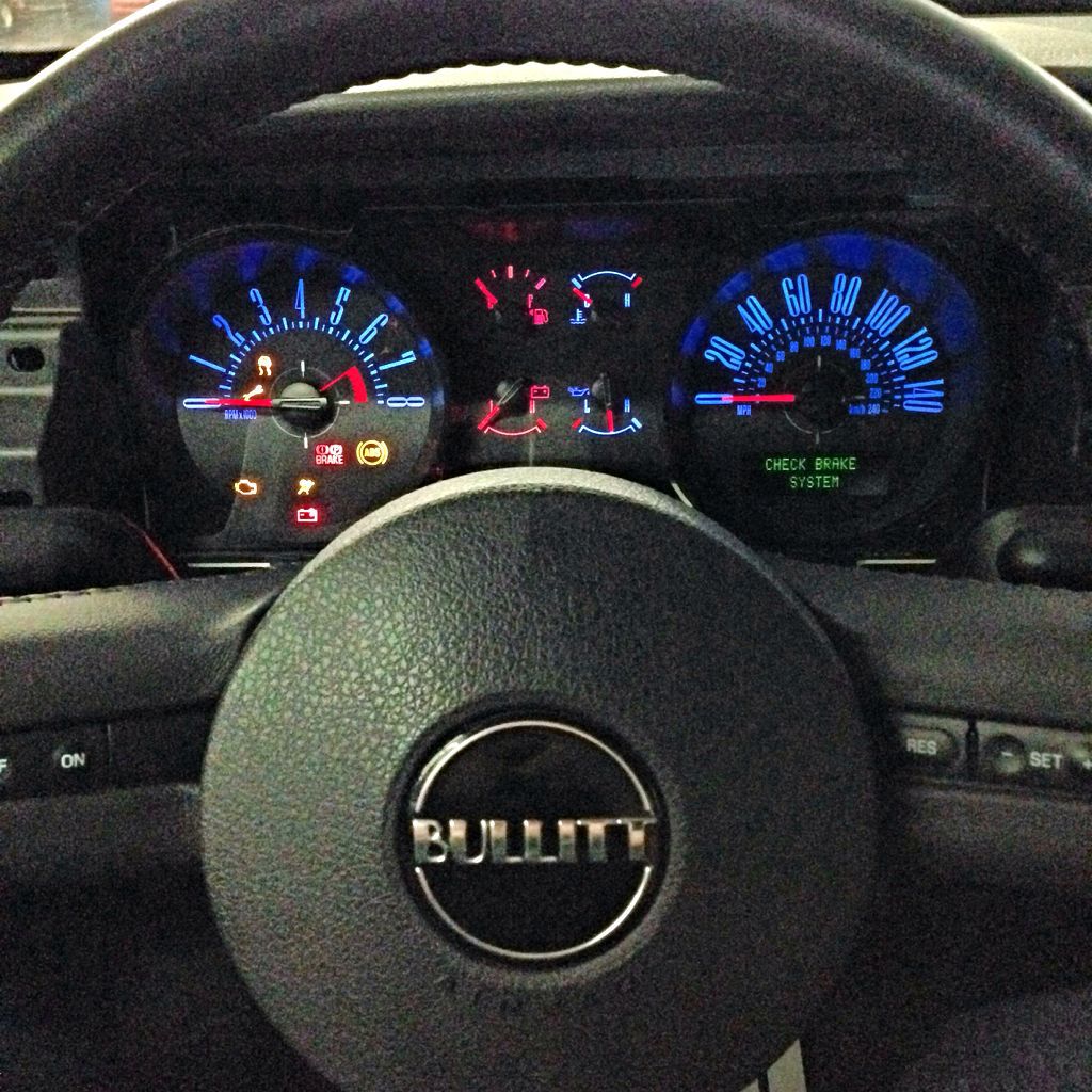

Not GT500 cluster swapping? Or did the Bullitt have special gauges?
The Bullitt has special gauges as well as a special dash.
What Brian said, if you look at my images, you can see the crosshairs in the Bullitt cluster. But no, I'm keeping the stock cluster.
