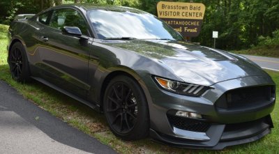

Purchased a 2017 S550 Mustang GT350 5.2L VooDoo

Actually the manual states the 1000 miles is normal, 500 is not, and Ford considers that to be guarded and to continue to watch. They have not approved many engine replacment at 1 qt / 500, they should because some have popped around there at the track. once I noticed the oil issue I did not track the car.

thats how I am doing it this time, just not going to redline till after 500 mi, and an oil change.

FWIW I have 17 GT350 as well. I bought used. It's at 12500 miles. I am not seeing oil consumption issues. I think the combination of hard plated cylinders (no sleeves) with forged pistons, and unknowing dealers/buyers not following the break in procedure, and/or not letting the engine warm up a little causes ring sealing issues.

I waited until 1000 miles before going over 4500 Rpm (8200 is the red-line). It pulls hard to 8000 Rpm. No oil use but bought some just in case I need to top it off.Voodoo3a.JPG
