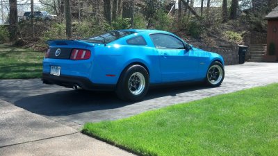

And I would really consider the 15x10 Welds. No spacers needed and the sway bar relocation brackets take maybe 10 minutes to do. Nothing else needed. More tire choices as well.

If you look at the rim size recommendations, the 10" rim is actually too wide for the 255 and the 275 Mickey DRs. Sure, you can probably stretch it, but they look all goofy when stretched. The 255 is the only one close to the 27" stock tire size too :\ I only have 3.15 gears so would rather stay away from the 28" tires for now.
What kind of gains did you see at the track with the boss intake? :)

^ As you can see in my picture above, the 11.50" wide Hoosiers fit fine on the 9" rim. I would only use a 10" rim if you're pushing over 600hp and need lots of rubber on the ground.

Well I wouldn't be running any 255 drag radial period. I run a 295/55-15 which comes in at 27.8" tall. Works well with my auto/3.15 combo. But most are running a 28" tire with their auto with 3.15/3.31 gears and with a converter running low 11's high 10's.
I did the Boss Intake at the same time as my converter and picked up six tenths.
