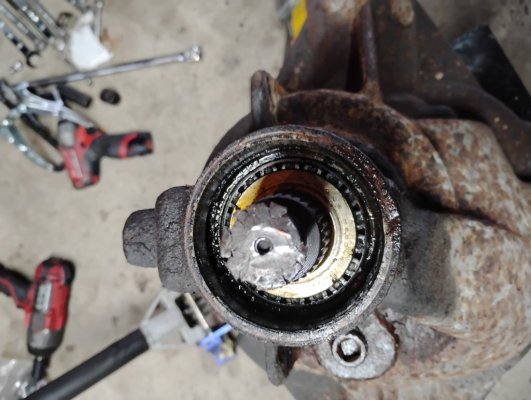

Getting into the gears and I'm at a loss here .
I cannot get this pinion out of the housing to save my life..
I've tried pb blaster.
I've tried heat.
I've tried all three and a 5lb sledge and I can't get it..
I did however manage to mushroom the shaft from hitting it so hard .
So can anyone leave me on some insight as to what to do next?
Thanks guys

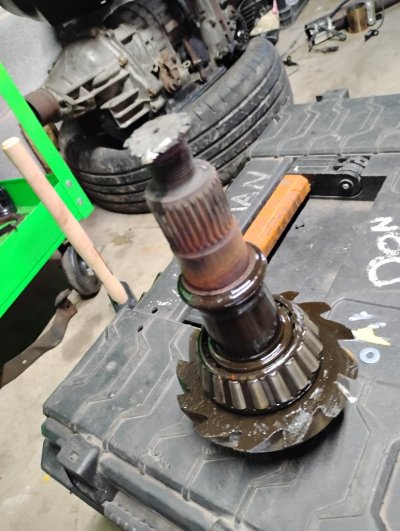

Thanks guys.... I heated it up and beat it with a 4lb o got at harbor freight.. I only had a 3lb
Juice
Aug 24, 2017
5,024
2,149
A tad rusty eh? Congrats, feels good to win.

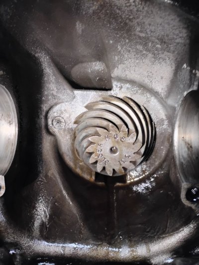

Yea, splines look funky, but that was not keeping the bearing stuck.
