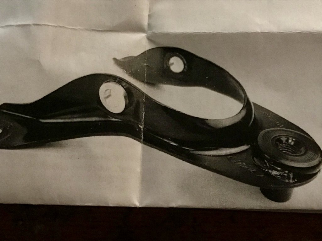

Step washer on the bushing that connects to the mount? Also, where would the step washer be installed, both sides of the bushing? Lets me know if anyone figures this out, have a great day my fellow S197 owners
I hope this clears up where the step washers go.
Yes! I was doing more research and you are correct it is the hole in the OEM upper control arm mount. UMI performance sells these step washers. The hole in the mount is 16mm and the step washer makes the hole 14mm.Thanks for the heads up Monkeyporn!
No Problem I hope it fixes the issue.

AFAIK, those step washers are for installing an aftermarket UCA into a stock UCA mount (or an 11-14 arm into a 05-10 mount, I think). If you bought an aftermarket arm and mount, you shouldn't need the washers. I'm pretty sure you would notice something very wrong when putting M14 bolt into an M16 hole.
It's been awhile since I messed with the UCA, but I believe I found a fractional size bolt that was a better/tighter fit through the mounting holes than the supplied metric bolt.
