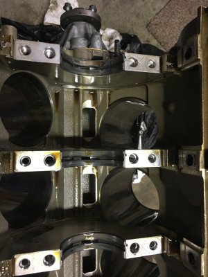

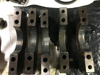

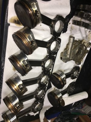

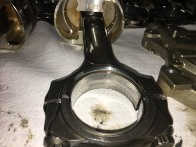

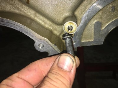

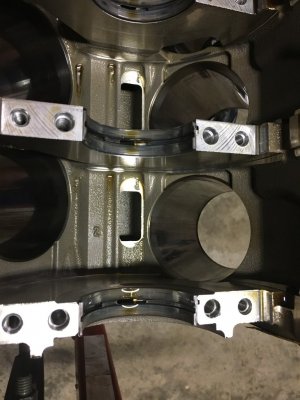

Got it tore down tonight and found bearings worn but all journals good, mains looked worse than the rods and appeared to be wearing more on the edge than across the entire surface. I do run a dedicated 10 rib drive on a whipple that sees 17 lbs. one of my tensioner arms studs was broken and laying in the oil pan, one piston pin seized in the piston, milky shit on 5 heads studs, and one piston hole full of surface rust. Also a few of the head studs were extremely tight in the holes and I ran them down by hand and didnt tighten when assembled. wondering if I even trust the block now. Ive got a brand new set of stage 3 heads with manley beadloc oversized valves and 127550's. you guys know if its possible to check head bolt threads for cracks ? pistons have a little scuffing on skirts. going to go back with billet arms, tensioners, reluctor wheel, and adjustable gears and degree cams this go round. Any ideas on bearing wear or the bolt holes ?
