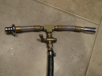

The arrow is pointing to where I disconnect the line and insert the "T" (sorry for the old pic, but its the best I could find).
Just to the right of Don's arrow,remove the sending unit for the fuel pressure guage,screw in an NPT 1/8" x 3" nipple vinyl tubing,hose clamp & you are done.It's a 2 minute job.
Simon
Aug 13, 2008
251
I have the Kenne Bell, so removing the FPS is not an easy task.
This is what I use. I bought a $5 tool from the auto part store to seperate the line. I take it apart after the car has sit for a few mintutes and I need a small paper towell for any fuel. Start the car with the valve closed and then open it up all the way after I start it. When the tank gets low and the pumps have a hard time building enough pressure to tkeep the car going, I just close the valve a little bit and let it build some pressure. It's pretty handy and it ensures I get my tank empty for when I run race fuel.
I have the KB 2.6 as well,it can't get any easier or quicker just unplug the wires & unscrew it!
