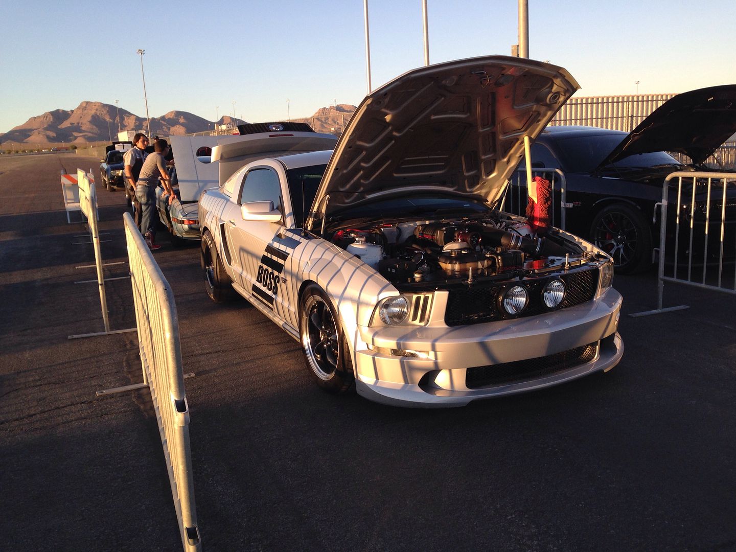

Here was my solution. Fits perfect between the strut tower and a little notch in the hood. What's really nice about it is that it serves a dual purpose. Sometimes I use it to dust my car off. How cool is that?
