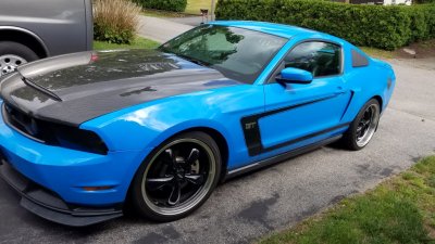

I have billet style wheels in the 20" size with deep dish in the rear. Trying to figure out space size for the basic 4 pot brembos.
