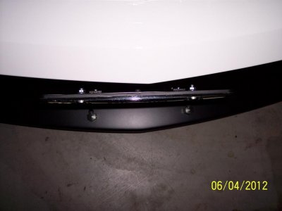

mustangflanagan:
Better late than never!
Here are some pics that show the bracket in (normal), pulled out (1" further out than normal), and a side view in the normal position. Bumper is a 2012 and it has a slight point to it. Don't know how it compares to the Roush bumper.
Chris
