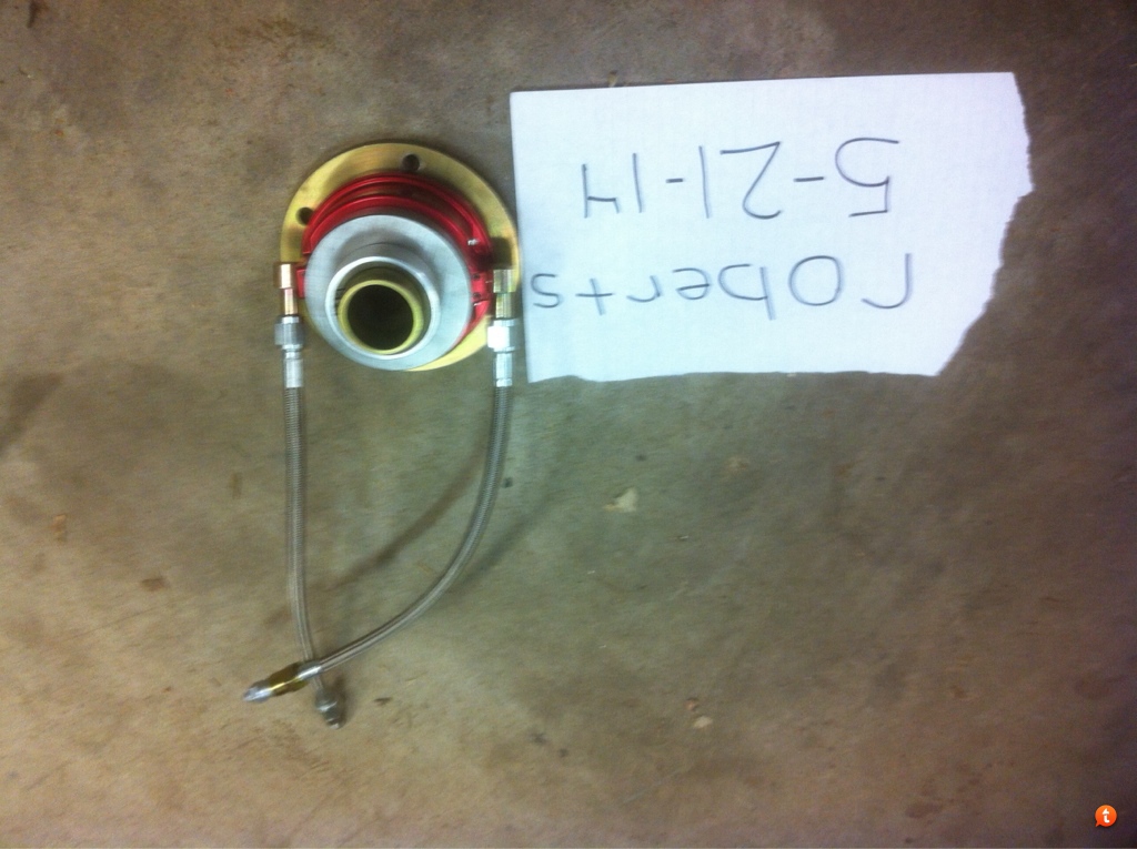

roberts
Jul 19, 2011
1,481
Bonne Terre, Missouri
What there hydralic throw out looks like I'll sell it as I didn't use it.
