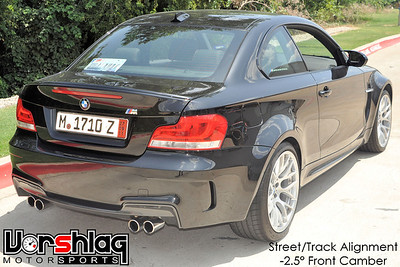

In the thread linked here I explained more about why camber is SO important to modern McStrut cars. I even showed the example of one of the OEM spring camber plates we make for the BMW 1M, and how well it has been received - because it pays for itself in the owners first track day.
Left: OEM 1M tires after 2 track sessions (no camber). Right: BMW 1M with Vorshlag OEM spring camber plates (up to -2.9° adjustment)

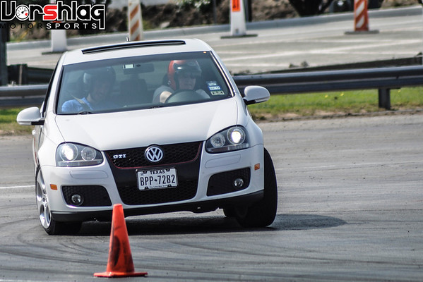

If your car doesn't have a "crash bolt" or camber slotting allowance repair from the factory (for YOUR year and model car) in the shop manual then you are SOL. Street tires are as easily damaged by lack of camber as R compounds, and in some cases worse so (Hoosier A6 is designed to work with less camber).
So when you guys running in the new Street class get tired of shredding your now 140 treadwear front tires, there's always Street Touring or Street Prepared (but those categories are hardly perfect). The first mod that is allowed in both classes that most people should do is: camber adjustment!
The two pictures at the top of my post are from an autocross 2 days ago, and both were Stock classed McPherson strut cars on street tires. Both suffered from a severe lack of front camber and exhibited MASSIVE understeer and significant front tire wear. That is common. Our red Mustang above ran at the same event, and made a metric truckload more grip on 315 A6 tires, but as you can see had less bodyroll and less camber loss, which came from the fact that it started off with -3.5° front negative camber... from our adjustable camber plates. This is a part that will pay for itself quickly, but the SEB failed to see that. :(
