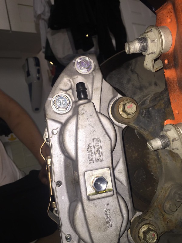

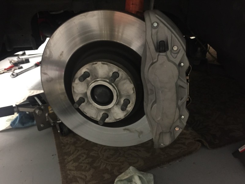

Got a chance to test this over the weekend. I know some people have been curious about this, but it turns out they bolt right up! Using the same bolts as the S197. This is with an S197 GT500 rotor, not sure if they are the same as the S550 4P rotors or not. You will need a different brake line, since the OEM S197 lines will not work. You should be able to use a 6P line from a 13/14 GT500.

Just a head up, these are even bigger than 4P brembos, so wheel options might suck. As far as the price goes, you'd have to talk to Kelly at BMR. This is his caliper, I just borrowed it to settle our curiosity. I do know he's interested in selling though.

Are they centered to the rotor? Hard to tell by the pics. Reason I ask is, I know the S550 rotors are completely different, with the outboard venting instead of inboard on the rotor hats.

Everything fit up just fine, it all looked good. The calipers were bolted down and I pressed the rotor flush with the hub. I'm not sure about the very front of the pad and where it falls on the swept area of the rotor, but it looks like it will work just fine with S197 Brembo rotors. I meant to grab a rotor from you before I tried this, but I was too darn busy this week to swing by.
