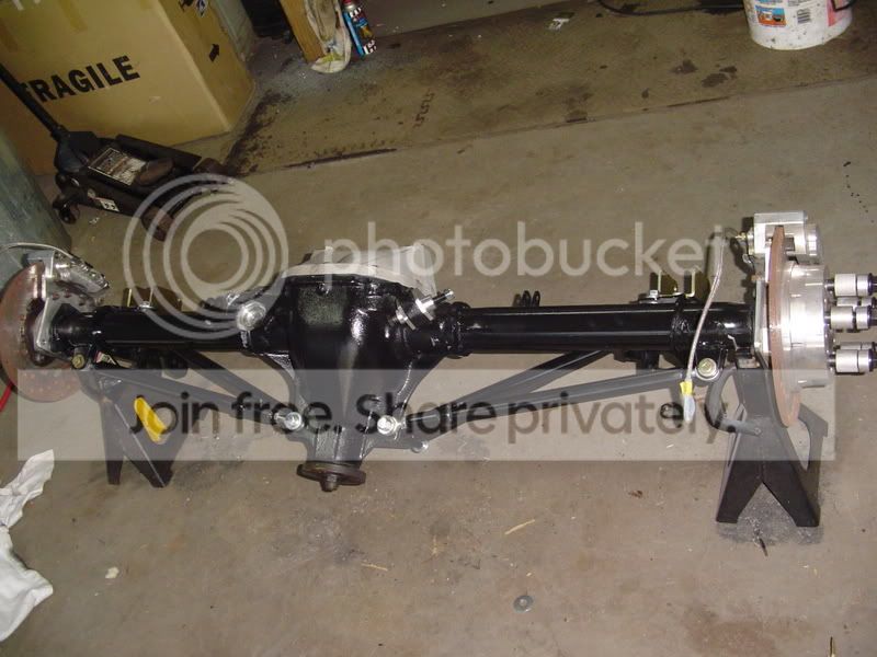

I will say it again, apparently he's never driven a car with a watts link. It has plenty of advantages for the drag crowd, namely straighter launches and the ability to fit wider wheels and tires without rubbing on the fenders because of the arc the rear suspension moves in on squat. More importantly it handles bumps significantly better than a PHB configuration does and I know drag strips are not perfectly flat!
I don't see an axle brace doing a whole lot for these cars and that is especially true if you look at the way the current offering (CHE) mounts to the rear axle. The way it is mounted braces it in the camber change direction which is probably the least changed direction on launching the car. The brace really needs to be at the same height as the axle tubes and bracing it in the toe direction.
Or if using alignment settings is too confusing to establish planes, the CHE brace braces the axle in the front/rear view which braces the axle against a force that it will most likely never see, that force being something pushing heavily in the center of the rear axle. About the only advantage I see it providing is the ability to use it as a jacking point.
The direction it NEEDS to brace the rear axle in is the plan view. Something that the CHE unit attempts to do in a different plane and is horribly inefficient at doing. The launch forces are going to attempt to fold the axle forward, not upward.
If I were designing an axle brace it would look similar to this:
Even that looks like a lot of dead weight to me. How many people are folding their rear axles on drag launches vs twisting tubes and shattering differentials?
