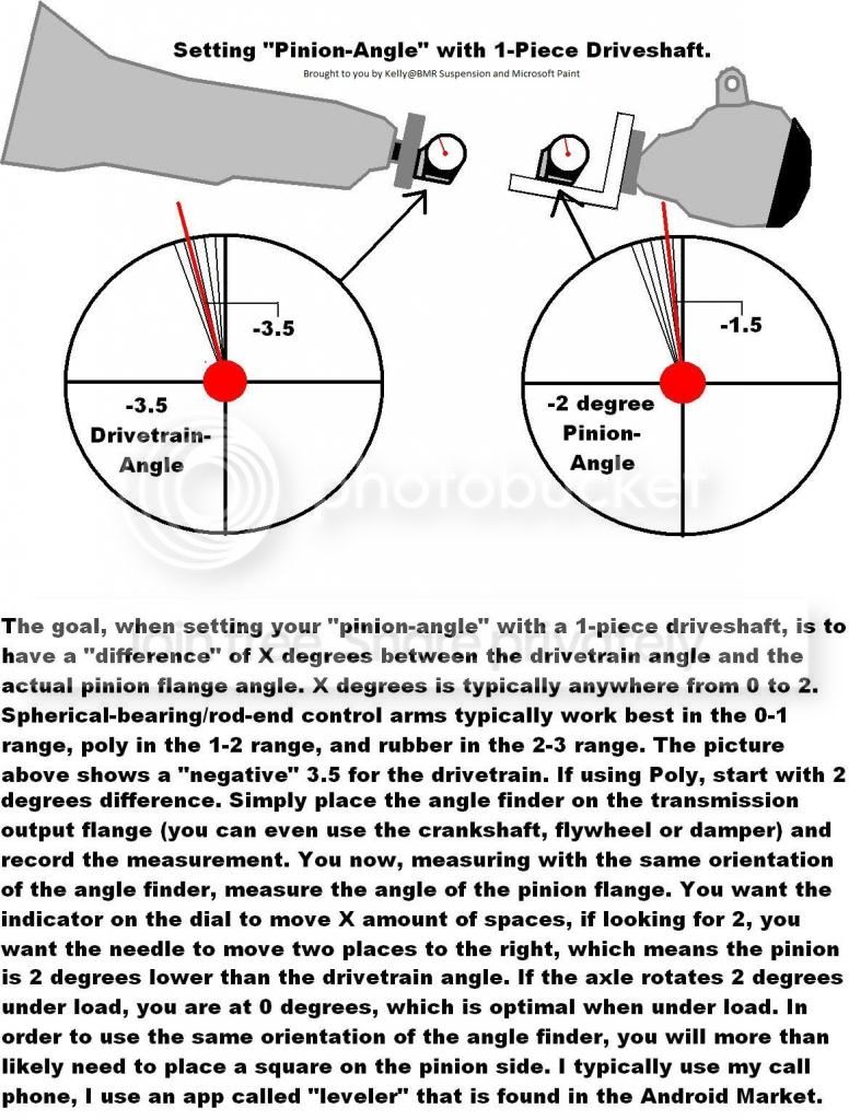

I like the Pinion Angle to be set the same, 1-piece or 2-piece.
No math. That is why people suck at setting pinion angle.

I measure the pinion flange against the crank damper.
If the D/S is in the car, I usually do and recommend the same.
Here is the picture I made up in paint.
I made this quickly, a long time ago, after realizing how many hours each day I spent trying to explain to people how to set it.
Hopefully, my video will be even easier. :highfive:

where do you put the angle finder if the D/S is in the car? i had taken the D/S off to do it and use a digital protractor but is a pain in the ass to remove the D/S until i get the engle i want or i need.
Do you recomend put it right under the U joint of the D/S in close by the rear end?

As was just posted, and says in that drawing, you can use the crank damper.
On the rear end side, there is a flat machined spot you can use on the flange.

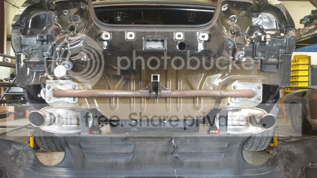

So, I go and check on some of the pieces we are working on....and to get a snap shot of the flange....and, I see this being worked on. lol
BMR Tech
Traction Vendor
Dec 15, 2009
4,863
13
Tampa, FL
Dat lost jig doe.
We made this piece in 04/05 for our 2005 Mustang we built way back..
When we decided recently to go ahead and offer this piece, we could not find our original info/jig....so apparently our design guy decided to go ahead and re-make it. lol
Our "design guy" is the founder of BMR. He is about as good as they come with development and design. Form and function!
Not sure how many of these we will sell, but, it can't hurt to offer more chassis and suspension parts for this car than anyone on the planet!

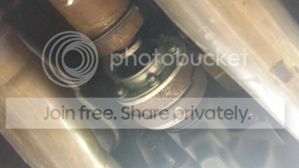

The area where the "spot" is painted.
That will measure exactly the same as the actual flat on the flange (when the DS is not installed)
And yes, we are still rocking the OEM Driveshaft....lol
Hope that helps.
Thanks a lot. I will have to check mine because I had to change the flange for the one piece aluminum drive shaft I brave. I hope is the same style which I think it looks like the same.
Hope that helps.
Just to be sure, doesn't that area with the paint on the flange have taper to it?
I take a piece of square tubing, place it on the edge of the flange and attach the angle finder to that.

It has a taper on the outer edge. There is about 3/4" of perfect flat to use.
wbt
Jul 9, 2010
2,323
I'll check on my car tomorrow but last I recall the area with the paint spot is tapered and will throw off measurements by 2*. I'll post some pics to confirm.

That area with paint is flat. You have to hold the angle finder real tight against it because like was stated, it's only about 3/4".
Interesting statement about measuring the same way with the two piece. I thought the back half of the DS had to be used.
