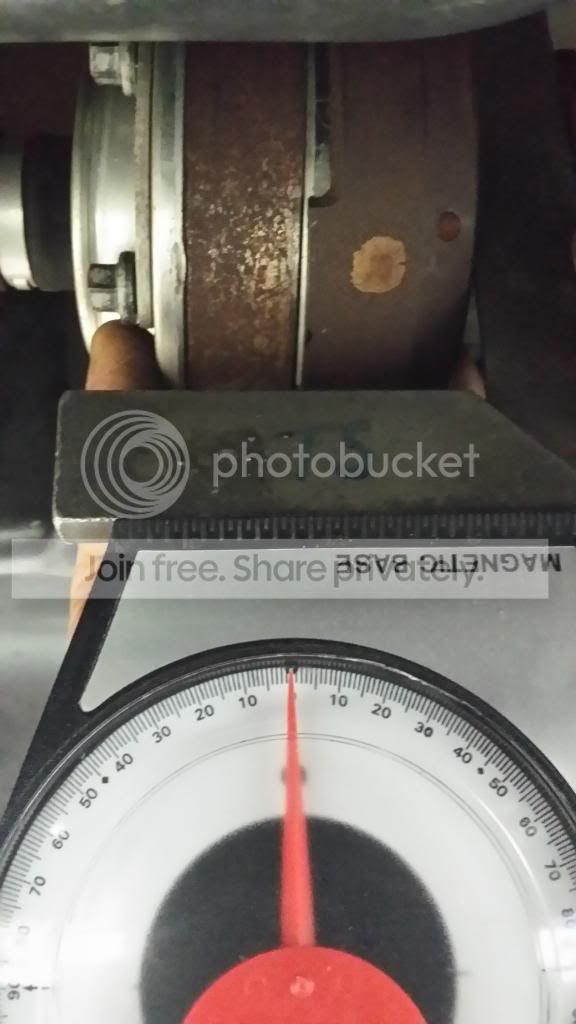

Here is the angle of the rear of the flange, using a square. In this picture - it is the exact angle. I ensured the complete flat portion - was flat against the square. This is why you will notice the angle finder is slightly shifted on the base plate of the square.

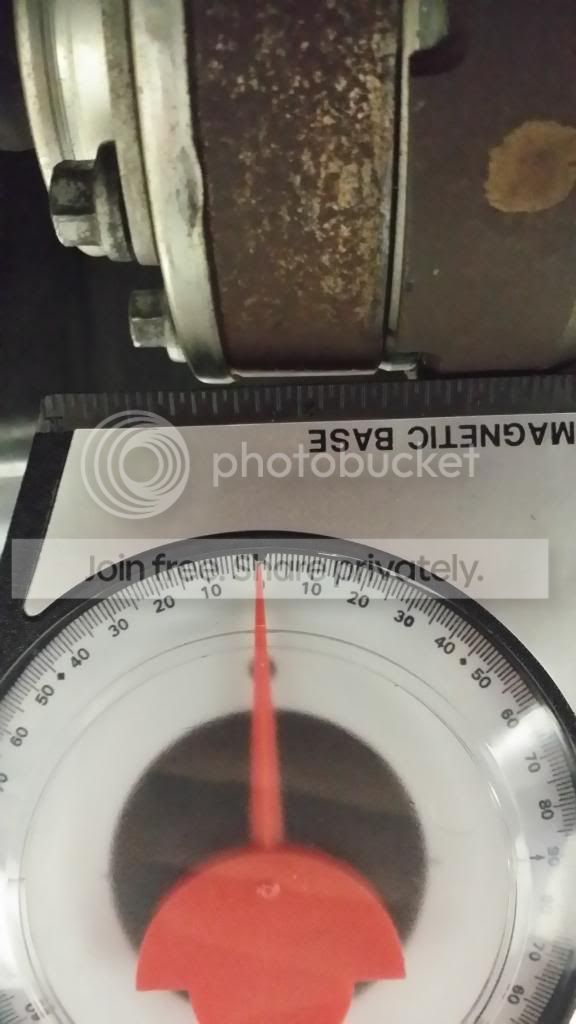

Here is the angle of the machined flat spot that we recommend taking angle measurement from. This is somewhat trickier than it seems, and I will try to remember to tell people to use a square off the backside, if possible. By using the magnet on this piece, I was able to almost swing a full degree in each direction, based on the position. I confirmed this angle reading with the base plate of the square - but it was WAY too difficult to snap a pic of that.

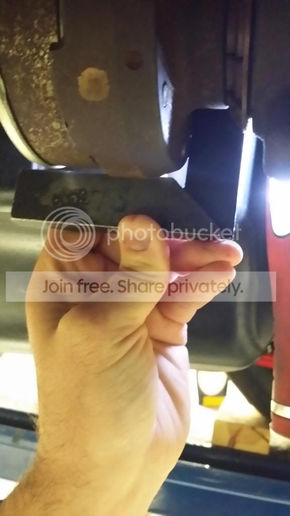

Here is a snapshot of the square mounted to the two spots. There is a "speckle" of light coming through, which is a "nick" in the metal. The light is very bright.

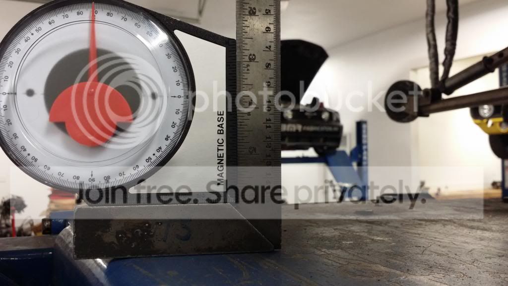

Here is a snap shot of the angle finder placed on the square I was using. They match perfectly.

Kelly in this image the square appears to be on the bolt. Is it or no? I ask because i see light at the top of it and bottom. Just want to be clear where to get my measurements from.
It is not on the bolt. It is between them - flat on the flange.
Measure from either place that I pictured. I got "0" on the back part of the flange....and "0" on the bottom.
