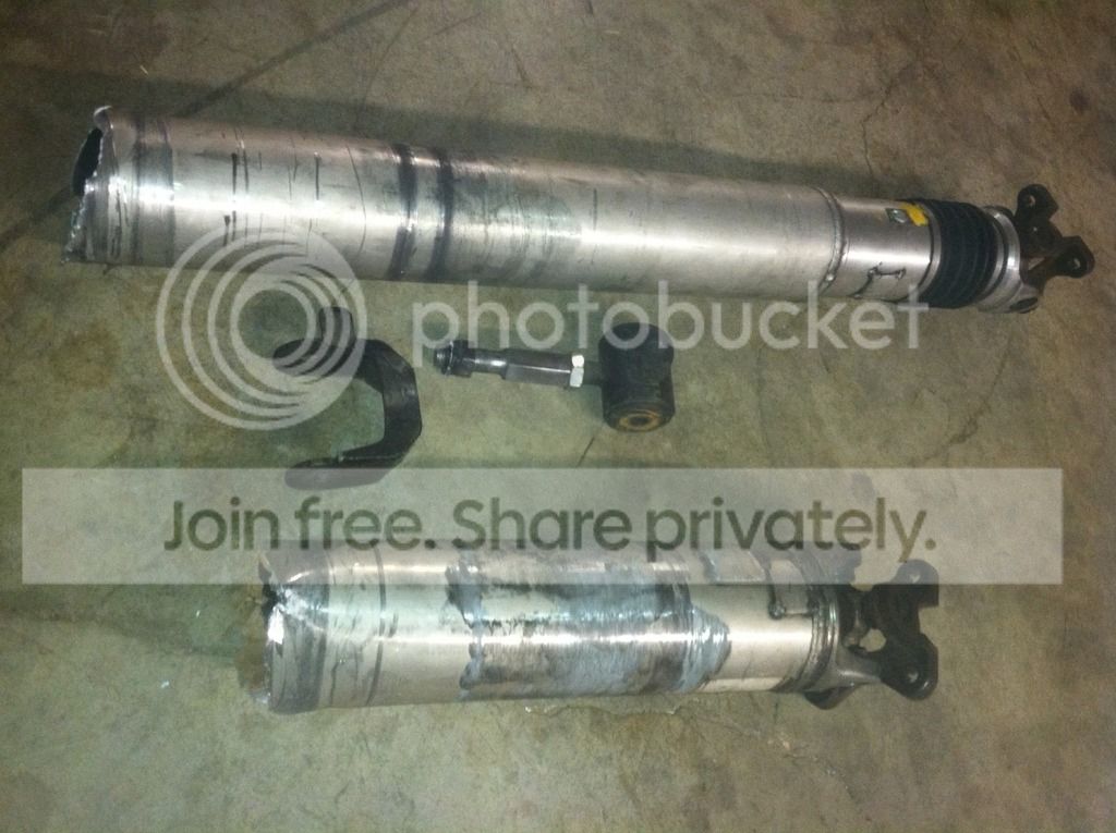

so howd this happen?
story behind it or just blam
BlindGUYnAR
Nov 23, 2014
109
Arkansas

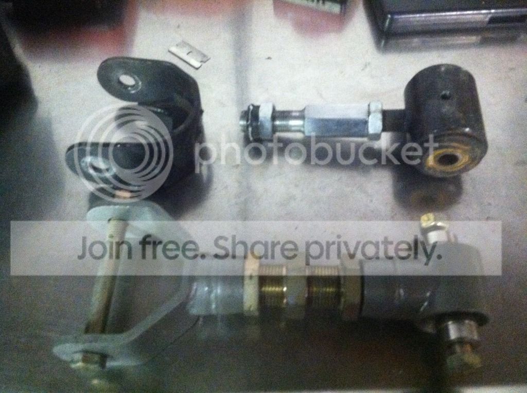

That control arm looks very weak. Like thin sheet metal. I'm guessing it broke first and the rearend rotated and put the DS at extreme angles to the point the u-joints bound up and it ripped in half.

Is that a CHE control arm? I thought these driveshafts were rated to 900HP lol.
I guess horsepower rating doesn't matter if the control arm breaks and ends up twisting the driveshaft.

Looks like a shaftmasters DS, which are known for braking lol

Well if you go look up pictures of a DSS shaft for an 05-09 They do not have U joints on both sides, they have a U joint along with a CV joint. Shaftmasters on the other hand uses ujoints on both sides...

Well, you're right. My Dynotech also had U joints at both ends. That's definitely not a DSS shaft.

Shaftmasters or Dynatech on the DS. Unless DSS had some original old design like that but it doesn't look anything like the DSS I just bought.

may have been. ive bought a few. I cant remember from all the shit I've bought and installed and traded and what not. may have been shaftmasters. going to gt a dss this week since theyre only an hour away unless someone wants to trade for a PI converter for their shaft as long as its built like dss' present unit
