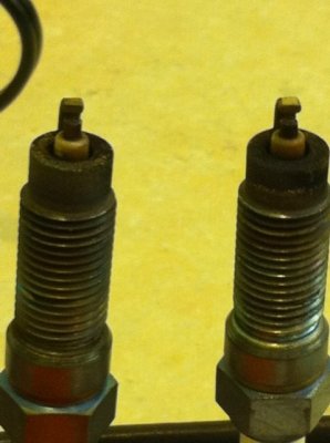

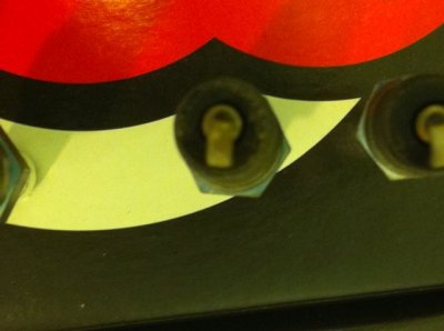

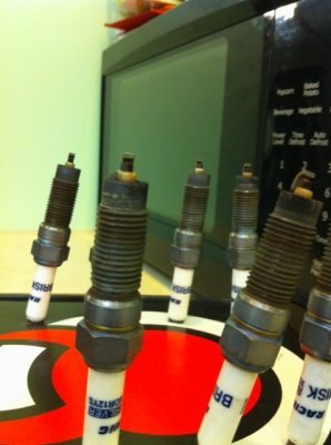

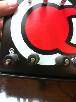

Ok, before yall flame me (which I know this has been covered a shit load) I am unsure of how you know its time to buy new plugs with my setup. Pay attention to how the plugs have alot of deposits and very course to the touch. These plugs has aprx 3000 miles on them and also burnt 14 gallons of 112 leaded race fuel. One step colder than factory BRISK gapped at .28 when installed but now when I checked gap tonight are up to .32-.34 I am trying to chase down my poor idle, stall issues and that was the sole purpose of this exploration. Here is pics.

Brisk plugs are junk IMHO.
I would get rid of them, and buy some Autolite HT0's and gap them to .28-.30 and see if that gets rid of the issue.

They have a weird electrode in them, that most times fails. I've tried them on my 07 GT, and they were pre-gapped from the vendor, the car ran like ass.
Swapped some HT0's and the car ran beautifully.
It's hit or miss, but most times, miss.
Overpriced junk IMO.

The Brisk plugs are also made in the Czech republic, and a lot of people had to end up changing the brisks after 5,000-7,000 miles. The HT0's will last at least 10,000 miles.

Leaded gas kills plugs and o2 sensors. Those plugs don't look so good.

Looks like normal plugs with Leaded gas. Get some new plugs and run Unleaded race fuel
