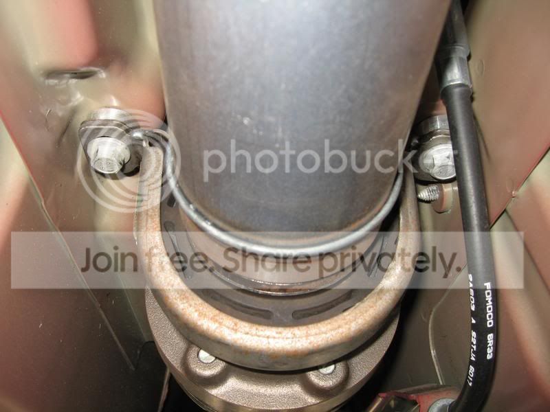

Thanks for write-up. Just a few questions to be sure I do this the correct way.
Are the instructions the same for autos?
What are the torque specs on both the tranny & pinion flange bolts, and is the X pattern the proper bolt install method?
Which, if any bolts or nuts are supplied with the Spyder, and which if any do Ford recommend replacing after removal?
Is the picture and description in Step 5 referring to this pic? (borrowed from Taco Bill):

Not really on the nut just on the flat area where it seats. Torque specs for the bolts on the tranny output and pinion flange are 76ft-lbs and yes make sure you torque them in a X pattern to prevent warping the flange. Spyder will provide you with new bolts for the pinion flange but you can re-use the ones for the output flange.
And yep step five is referring to the bolts in that pic.
