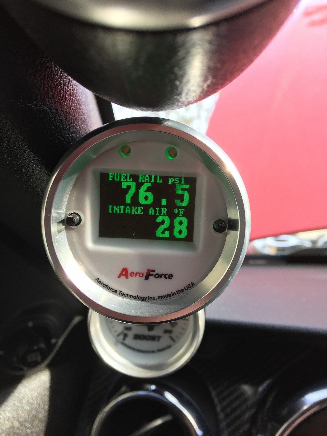

Right now after sitting overnight, it will start and idle, but then dies after 30-45 seconds. On my Aeroforce Interceptor I show a fuel rail pressure of 76.5. (Shouldn't it be at 39? Can anyone else with an Aeroforce Interceptor go check for me?) Fuel pump DC is showing 74 when it is idling. Battery voltage is 14.3; alternator is fairly new and battery is brand new.

To help folks in the future, here is what my Aeroforce Interceptor showed when the car was failing to run:

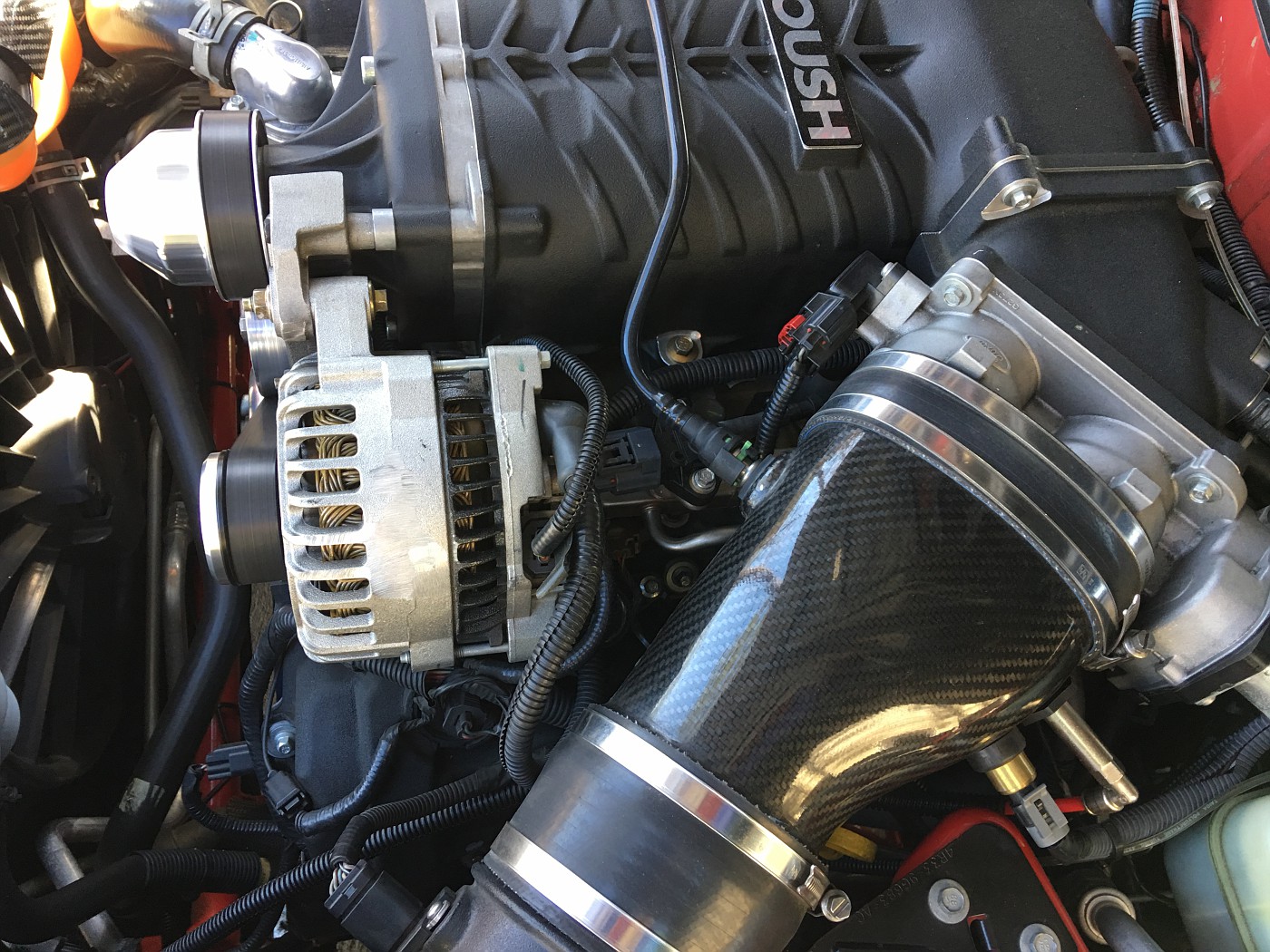

I swapped in the new FRPS...it was a tight fit due to the alternator location with the blower...but 5 minutes, two bolts, one vacuum line and a dab of engine assembly lube on the O-Ring and I am back in the game. Car is warming up (it's 20-some degrees here in ATL today!) and I'll go for a test drive to make sure all is well.

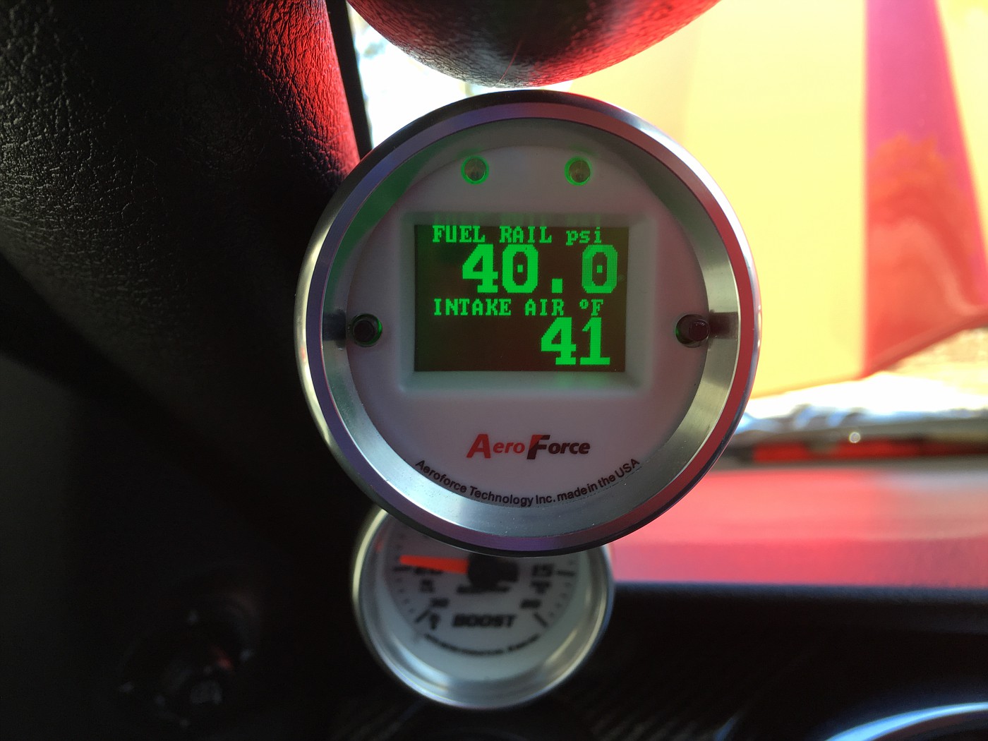

After swap (I understand 39 PSI to be target)

My aeroforce gauge shows 40 psi...at idle or any rpm. ( with key on, eng OFF, areoforce gauge will show 50 psi )
FPDC at idle is 40% Note, the aeroforce gauge will depict FPDC as exactly one half of what it actually is. IE: 20 = 40% 40 = 80% 50 = 100%.
I have 40% at idle...and 80% at wot / 6200 rpm.
On a side note, when my eng starting gagging a few yrs ago... but only when trying to get into boost, the cause was a clogged fuel sock over the oem fuel pump ( and not the fuel filter). With a clogged fuel sock, FPDC was almost maxed out at 98%, and fuel rail pressure was down to 5-6 psi... that was when I put my foot into it.
Just something to be aware of.
Glad you got it sorted out.

What do you guys know about a disc with a hole drilled in it that Kenne Bell sells to prevent blowing out FRPS sensors? I may give them a call and see about getting one. About $30 shipped. Just learned about them after this happened to me.
Don't think this design will work on our cars since the Bosch FRPS base has a protruding stem:
