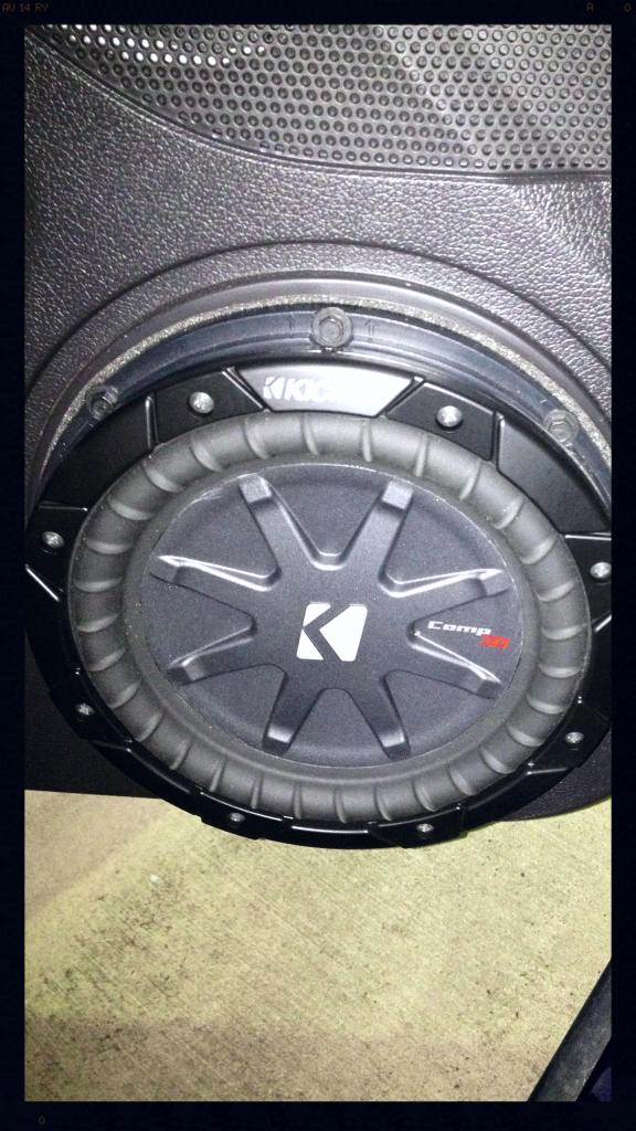

So the new Kicker door subs arrived today, and I could not wait to put them in and get rid of listening to crappy sound.
Took me about an hour and a half and the difference is alot better. Even my wife can tell the difference and that there is more vocals and mid bass.
I need to put the Shelby/Kicker grills back on...but I have to drill four small holes for the grill to be screwed down.
