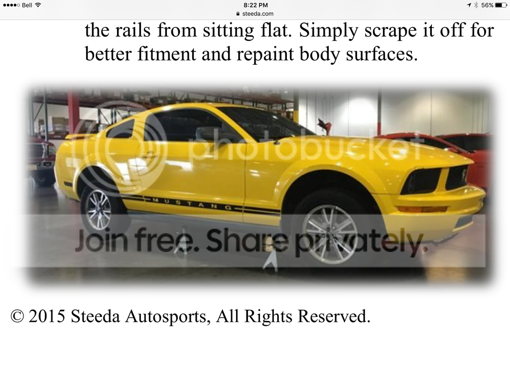

Mine arrived last week but haven't had the motivation to install yet. They do seem shorter than I had hoped. It would be nice to be able to set the car on 4 stands on the rails.
The instructions show that you can but the rear stand sure looks a long way forward. Anyone try this yet? Does the car feel good and stable?
