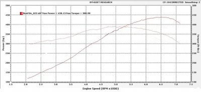

I can't recall if Bruce had FRPP heads on his 5.3, nor do I care to dive into the archives to check lol. I want to say they were stock with a port job, but it wouldn't surprise me if he chucked coin for the FRPP's. Not even sure if they're in production anymore. If they aren't, whoever is fortunate enough to have them, may be sitting on gold should they keep them in good shape. I don't think the factory heads will hinder reaching the 500whp mark, so long as they're ported and match the manifold and headers.
Here ya go:
Big Bore block. 3.701 x 3.750 = 323 cubic inches
12:1 compression
FRPP cnc heads that are supposed to flow 273 cfm at .500" lift
Livernois stage 3 blower cams
FRPP intake with 62mm tb
Mac LT headers, high flow cats
C&L racer cai
438/389 rwhp/tq with E85BBB 323 Stroker E85.jpg
That's still 62rwhp short of the 500rwhp mark despite being a high compression stroker with HCI. Finding it would be a very difficult task and the biggest limitation is cylinder head flow. A CNC ported 3V head just can't flow enough air to feed a 323ci motor that would need to spin to the minimum 7500rpm that would be required to produce 500rwhp.
