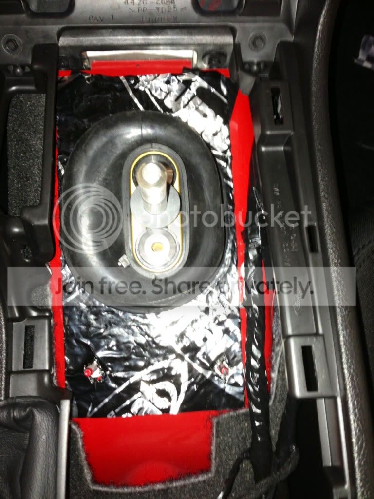

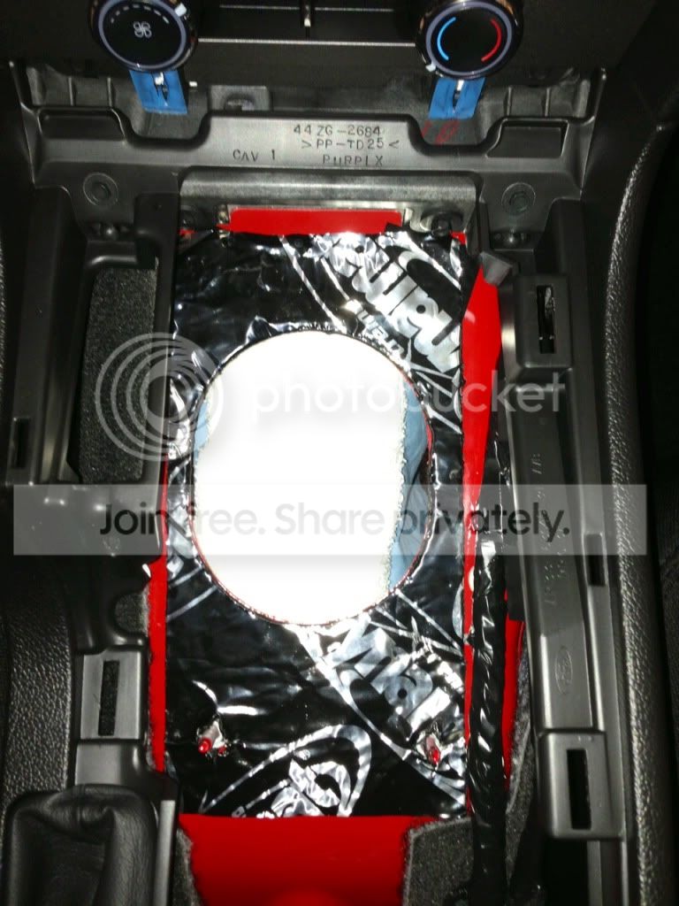

You're supposed to use one pad or the other. I believe they are of different durometers.
I did the same thing as shown in the picture with my dynamat.
