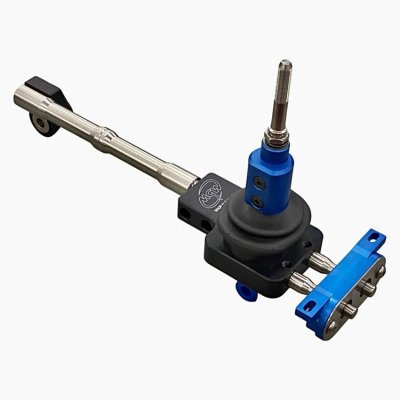

I couldn't imagine why it wouldn't fit; it's only held onto the body with two chintzy little nuts and I don't see how there could be any interference.

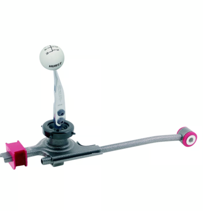

As you can see from the MGW, it's very beefy to combat the rail flex caused by the drivetrain torquing under heavy load while the body-mounted shifter wants to stay vertical. The other pictured is my Hurst which does nothing for the rail flex since it's just a basic entry. The throw reduction is nice but it will lock you out same the as factory one.

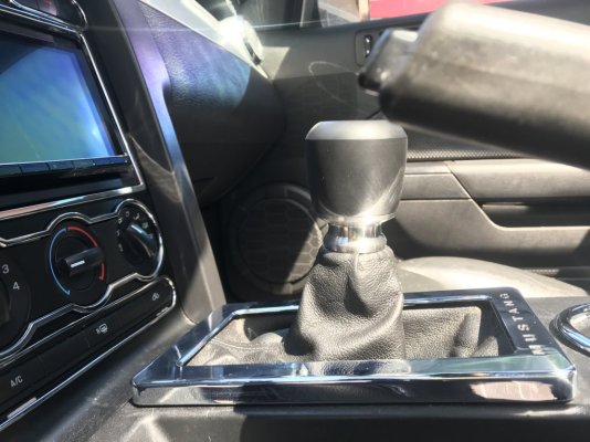

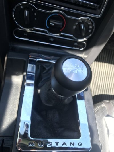

I know this suggestion may be to some out of bounds, but I'd also strongly suggest that you consider using a weighted shift knob w\ any aftermarket TR3650 ST shifter to counter the trans tendency to be notchy (reason why, IMHO, Ford made the OEM shifter handle as long as they did......) & assist in gear engagement during shifts, especially aggressive shifts. I use a Raceseng Topology Ford 1.2 lb weighted shift knob w\ shifter boot retainer for this TR3650 trans........they're not cheap but they look good & are a quality piece. The MGW's rugged build quality can easily handle the knob's weight & inertia w\o issue...........
Pictures of this shift knob provided below....................
