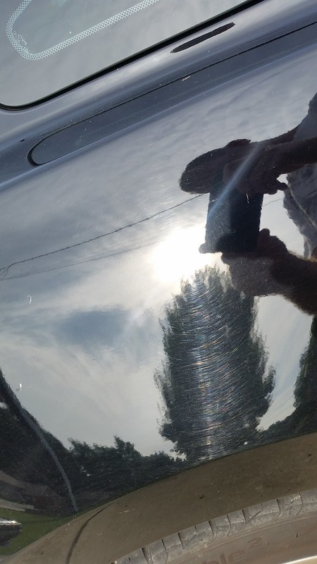

Swirls in paint!!!

I think you'll need something with more muscle to get those swirls out. I'm not sure what sort of results you'll get with swirl X either...I had a tube of this and threw it out when I got my PC 7424 and some Meguiars 105/205.

Yup. A decent DA buffer would be the starting point. PC, Griots, etc. Then pads and products.

I too have some light swirl marks that can only be see with direct sunlight at an angle. I tried using Meguairs Swirl X and their DA that attaches to a drill, using their yellow polishing pad I got zero results.
The paint color is cleaner and shines more for sure but after the wax I still saw the swirl marks.
Remember to try least aggressive products first. Swirl X is fairly abrasive IIRC but probably not so much with the tool you used to apply it. Perhaps start with a PC7424 using an orange pad and M205?

I think I will invest on a porter cable. Should I try the Swirl X again with the proper pad and tool this time?

Thought I'd jump in on this because swirl removal and paint restoration is one of my interests, especially on black vehicles.
What has been written so far is good advice:
- Porter Cable 7424 is a great entry level DA polisher. Stay away from rotary polishers.
- Meguiars 105 (or Ultimate Compound) with a Lake Country orange pad will remove most swirls but may leave slight marring.
- Meguiars 205 (or Ultimate Polish) with a Lake Country white pad will bring up the shine and add depth.
Finish with a good quality wax or paint sealant.
The Autogeek videos are a good start to get tips on technique.
